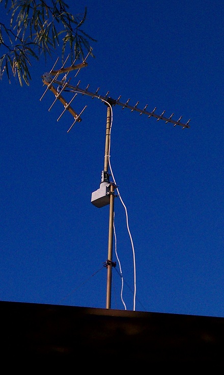

I've been receiving OTA all the major networks and Tucson channels for years with a good sized VHF/UHF antenna in my attic. The only problem in NW Tucson is that we are shadowed to the transmitters on Mt Bigelow to the east where most of the major network transmitters are located. Because of this ABC, NBC and CBS have rebroadcasting translators to the south of Tucson. The problem is FOX, channel 11 does not have an alternate transmitter. Years ago before digital I could pick up Ch 11 with a rooftop antenna, cut for VHF 11, and a preamp. But the preamp is long gone and Ch 11 now broadcasts on RF 25. I still have a decent UHF antenna on the roof but can't get Ch 11 on 25, especially without a preamp. I thought I would give Phoenix a try and pointed my rooftop UHF towards Phoenix. It is a straight shot 90 miles up I10 to south mountain without any noticeable obstructions. I did a scan and wow! I picked up about 15 Phoenix stations including FOX Ch 10. (BTW, FOX 10 broadcasts on RF 10 but I found it on 10.2 RF 26, not listed on my TV Fool report, but found here http://www.ask.com/wiki/List_of_tele...ons_in_Arizona).
I thought all was good until I went to watch the superbowl on FOX and found all the Phoenix channels GONE! I messed around with the antenna, cabling, connections, direction, etc. all to no avail. Later I discovered all the channels come in fine late at night and in the morning and disappear around 11am. From what I have read this may be due to some tropospheric conditions that change as the desert heats up during the day. I'm thinking a better antenna or preamp may be needed to boost the gain enough to get past these conditions. Is there a better antenna that you believe could help? Preferrably without a preamp. Or other suggestions? I don't believe I need VHF since I can get Ch 10 on RF26.
My current rooftop UHF is a 30 year old, maybe winegard, at 21 ft. IMAG1754smaller.jpg

With some time off from work over the holidays I was finally able to get back to this project of trying to receive Fox Ch 11, RF 25, from Mt Bigelow in Tucson. Thanks for all your recommendations, I believe I used most all of them and have some good news, and some weird news.
First I purchased an RCA TVPRAMP1R preamplifier and installed it with my existing rooftop UHF antenna. I tried different aim points, both horizontally and vertically. No sign of Ch 11.
Next I purchased a CM4228HD and installed it with the preamp on the roof in place of my old UHF antenna. Again I tried many aim points with no success.
I was ready to give up, but thought I would give it one last attempt using more of your recommendations. I removed the antenna from the roof, hooked up a new shorter coax with the preamp, and used a smaller TV that I could take in my backyard that faces the mountains where the transmitters are located. With everything on the ground and the antenna facing the mountain I did a scan, and WOW! Immaculate reception! I'm now getting channel 11.
The next step was to determine what was now allowing me to receive a decent signal. Was it the new shorter coax with no splitters, a different TV, antenna location, etc. Any guesses?
I'll spare you all the trial and error, but it turned out to be the antenna location. I thought if I could receive a good signal with the antenna on the ground it would be even better if I could find the ultimate spot on the roof. So I tried various spots on the roof and even attached the antenna to a mast that I could move around manually trying different locations, heights and aim points. Turns out it would not work at all anywhere above 5-6 feet. In fact it would not work as well even raised 2-3 ft. off the floor of my back porch. But sitting directly on the concrete facing the mountain I could get 71% on the strength meter. Ok, it's getting weird now.
I went back to the TV Fool report, and sure enough, if I put in 1 ft. antenna height it gives me better numbers than 10 or 20 feet. 1 ft. = +4.5 db, 10 ft. = -0.7 db, 20 ft = -1.3 db. So apparently the TV Fool calculations knows about this weirdness. I did some searching on this and best I could find is that sometimes with 2 edge signals and mountains you can get a phenomenon where the RF signals will travel along the ground following the terrain. OoooK. It's true, antennas and RF are a little bit voodoo.
I reconnected to my standard house cables, splitter and big TV and it all works with the same good signal strength, as long as the antenna is on the ground.
Now I have to figure out the best way to setup the CM4228 on the concrete floor of my back porch. Any thoughts on mounting an antenna to sit on the floor, or any other tests I should try would be appreciated.
