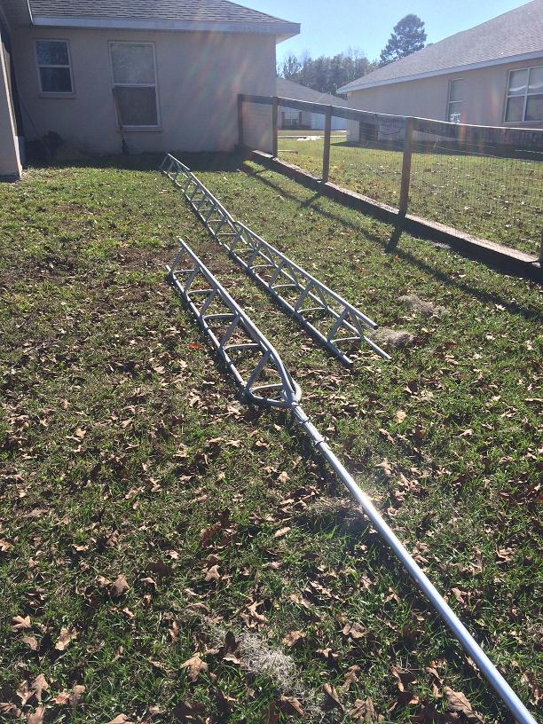

We finally cut the cable on DirecTV, and a couple days ago, my aunt gave me her old TV antenna tower along with an old antenna she had on top of it which is in great shape. I spent yesterday brushing down some surface rust with a wire wheel on my angle grinder, and I spray-coated the tower with cold galvanazing solution. Turned out looking great!
For now, I am going to get this thing up in the air with the small antenna (1' x 2', pictured) that my aunt gave me. However, I would like to purchase an antenna for myself to get the most amount of channels possible. Here is my TV Fool:
http://www.tvfool.com/?option=com_wr...d24354144ca7b7
My actual tower length is going to be about 37 foot (I think I am going to saw down the mast I put on last night by about 5' or so, just so it is more sturdy). Keep in mind that a lot of fill dirt was brought in (I believe) when my home was constructed, I am thinking about 5' or so... Not sure if I can count this towards antenna height. So lets just say 40' antenna tower.

Here are the pics
rierhog14 is offline   Reply With Quote

Ok gotcha. I'm leaning towards just aiming towards the north and forgetting about the south-east, at least for now. First I gotta get this dang thing up in the air...

Not too thrilled.... Only receiving 12 channells... Hell I received 8 with the thibg sittin on my back porch! I really thought sticking it 40' up in the sky would make a huge difference.... My tower is just stuck in the hole as of right now, and is leaning down, which faces the antenna towards the earth a tad. I can see this causing some issues, so will update once I get it all level and squared away. I've pretty much got it pointing due north.

At best, you're only going to reliably get 6 stations from the north with a total of 15 channels. That's all there is, you cannot get something that isn't there.
Make sure the antenna is correctly oriented vertically (there is substantial cross-polarization rejection by design) and that it is facing the horizon, not the earth.
