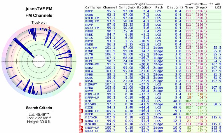

Your FM signal report; the second strongest FM signal report I have ever seen:
http://www.fmfool.com/modeling/tmp/3...5/Radar-FM.png
Very likely to cause interference to TV reception.
You must ground the coax with a grounding block connected to the house electrical system ground to make the FM filter (or two FM filters in series) effective.
