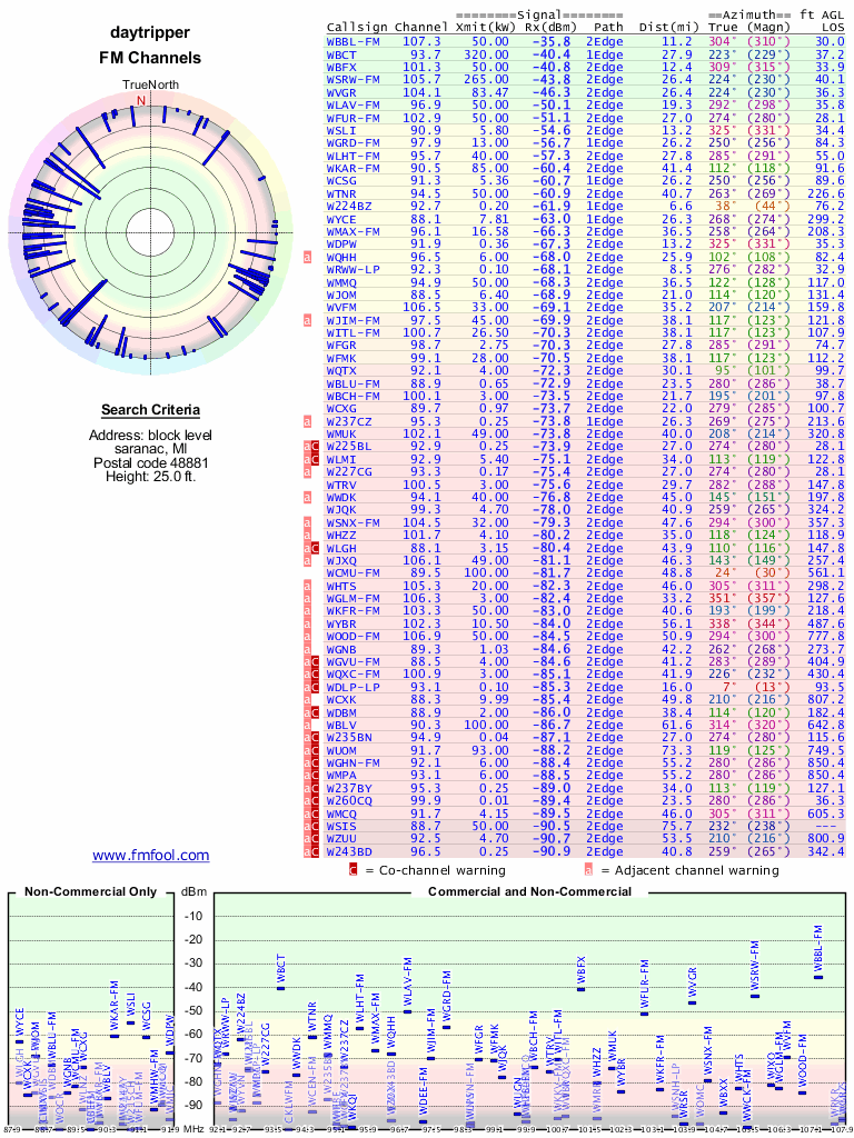

Attached is the analysis for my home. Yes, this is the setup I got from Radio Shack before they went belly up. It worked for awhile then gradually got worse.
I have no immediately tall trees close by and I live in the country with acerage around me.

The plot you attached is for FM Radio.
To make a TV plot use these instructions: http://forum.tvfool.com/showthread.php?t=14508
