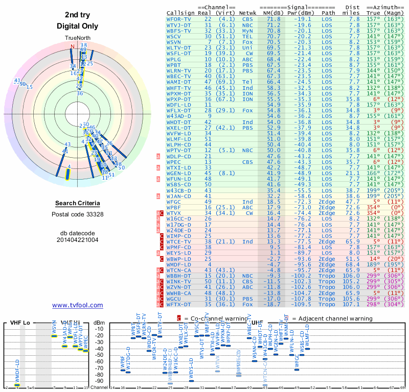

I got rid of my cable provider and tried rabbit ears (Radio Shack VHF, UHF) and got almost nothing until I touched both ends of the antenna to a window frame. Now I get about a dozen stations.
During a recent home improvement it was found that my home has foil backed sheetrock. I've also always had lousy FM stereo reception in this house. Due to having a condo association to deal with my options seem to be an attic antenna, or an unobtrusive outside antenna. It seems the wiring and I assume grounding requirements of an attic setup would be simpler. Being near the east coast most stations are either north , or south of me. 12 feet would probably be my maximum height.

It seems I've failed to provide a good attachment. My zip code is 33328. Flat terrain and no nearby buildings.

2nd try with attachment.

Aim at 155 degrees magnetic. Southeast.
A clearstream 2-V would work well or a db2 and vhf kit.
If inside the building, aim through a window toward towers.
No amplification reqired, many strong green signals. Only use it if you have many tv's
You will receive many channels!
Your TVFOOL plot looks similar to mine when it comes to signal strength.

Thanks for the reply. The problem with aiming at the many southern stations is that many of them are in Spanish which I don't speak. I would like to get stations from the north also where English is the major language. I need to get above my foil lined sheet rock and I think I want an omni, or multi directional solution. No windows in my attic, and I have a hip roof so no gable ends to attach a pole to.

Since my signals are coming from 2 almost opposite directions could I combine 2 directional antennas. I'm a total newbie so please be clear about what would be required to do this if it's possible.

Larger antenna aimed at 10 degrees magnetic. One that is directional but still a wide beam width. You would pick up all stations in green and maybe some yellow ones. The back of antenna will provide sufficient gain for south group in green. The attic is an unpredictable reception environment. Good luck

I would think a single antenna option orientated to magnetic 11 degrees for West Palm Beach could work. Miami signals are so strong, a coat hanger could literally receive them. There should be plenty of signal off the rear quarter of a single antenna to get most of, if not all of Miami.
Being orientated to magnetic 11, mount antenna outdoors and with an obstructed view of the horizon if possible.
If I were attempting this, I'd install an Antennacraft HBU22.

In that configuration, one ANT751 appears to being used for a single channel, while the other works the rest of the band.
You can combine antennas, but it gets tricky. Normally when you see two antennas there are few common scenarios:
1: One for VHF, the other for UHF, antennas combined with a combiner/preamp.
2: One for UHF/VHF band coverage except one single channel, the second antenna for a single channel. This is accomplished by a Channel Master Joinantenna, which is a bandpass filter. It allows all channels through except one - that one channel is what the other antenna is aimed to.
3: One for UHF/VHF coverage, the other for UHF/VHF coverage. Both antennas are separate and feed down to an A/B switch and you toggle between systems.
4: One antenna aimed at specific channel, second antenna is aimed to nullify interfering signal. This is a sophisticated method to combat co-channel interference when you desire a signal that has an interfering source. This isn't really applicable in your case.
There are some more high tech methods of combining, but these are several of the most common.
The point here is that you can't just combine VHF/UHF antennas with another VHF/UHF antenna with just a run of the mill 2 way splitter. You are combining two independent sets of signals which run the great risk of offsetting themselves and creating interference to one another. The result on your TV screen would be no reception or erratic reception.
Your TV with these clashing signals won't be able to lock. Think of it as being blinded by two bright lights and trying to see in front of you.
Seems to me the single antenna option would be the easiest.
