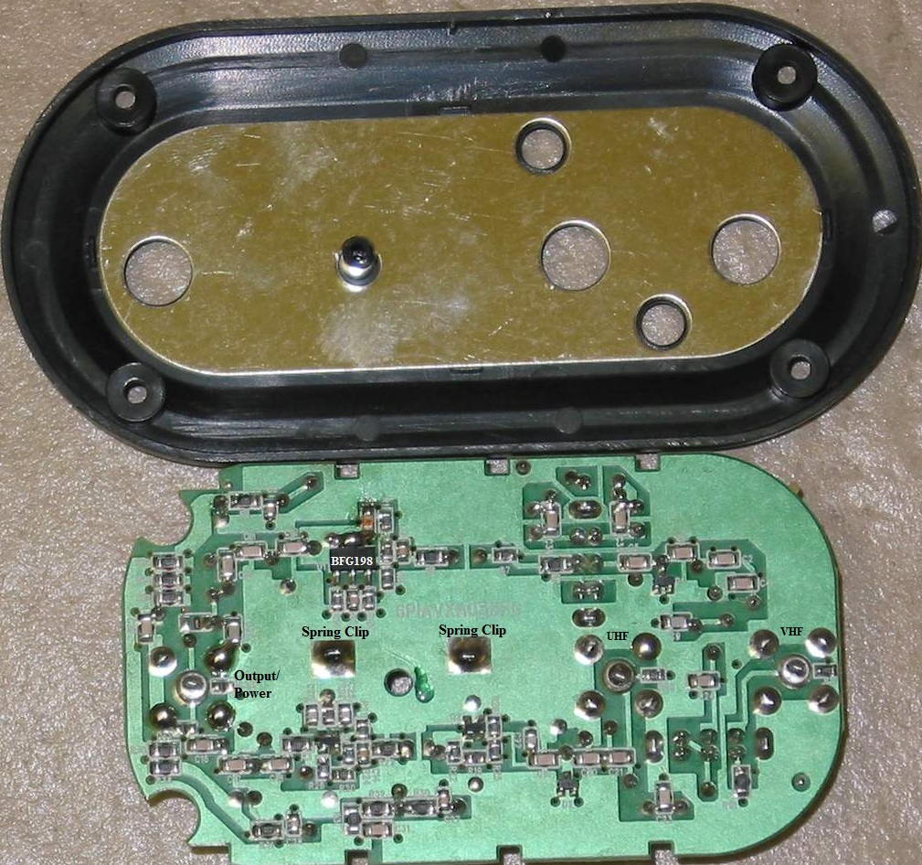

I want to report my findings with my new RCA TVPRAMP1R Amplifier. This looks like one of the few remaining switchable dual VHF/UHF input, mast mounted, pre-amps. with a switchable FM trap. I got mine for $22.80 delivered from NothingButSoftware.com, but they are available through Walmart for $21.95, Office Depot for $22.99 and Solid Signal for $27.99 plus $4.95 shipping.
Manufacturer (for RCA) is VOXX International

He also provided his sweep data of the FM Trap which I plotted. He used an HP 8970A that makes simultaneous noise figure and gain measurements. 5 data points were missing due to an 8970A annoyance in its data output where if the measured NF exceeds its self-calibrated max input (usually between 30 and 35 dB NF), it outputs a standard "garbage" value for both NF and gain that has to be ignored. Rather than substitute “filler” values, I chose to ignore the missing data. His data indicate a double notch filter offset to prevent channel six attenuation.
The supplied power brick is hard wired to the power inserter and is rated @ 12 VDC, 200 ma. Mine actually outputs 16.63 VDC. Output from the power inserter measured 9.50 VDC unloaded and 9.47 VDC with the amplifier connected. This is important to know because unlike my Winegard amps that have the voltage regulation in the mast head unit the RCA amp. has the regulation in the power inserter. For long cable runs or if you decide to use a different power supply/inserter you will need to insure 9-10 volts is delivered to the amp. I took mine apart to compare it to both of my Winegard preamps.
I probably wouldn’t have bought the RCA TVPRAMP1R Amplifier if ADTech hadn’t indicated they bench checked pretty good (compared to other preamps. he’s tested), well that and the fact that it only cost $22.80 delivered. I owe him a debt of gratitude for all the work he’s done and for sharing his data.

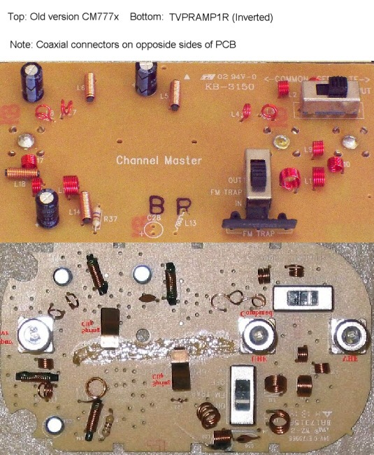

Compare Original CM-777x to TVPRAMP1R
Originally Posted by Pete Higgins View Post
... report my findings with my new RCA TVPRAMP1R Amplifier. This looks like one of the few remaining switchable dual VHF/UHF input, mast mounted, pre-amps. with a switchable FM trap.
Hi Pete.
Thank you for your efforts.
Your efforts to characterize and describe components are undoubtedly helpful to many others.
Thank you for your images.
They looked familiar.
Attached are a couple of images comparing images of the original CM-777x to your image of the RCA preamp.
The image below is the coil/switch side of the PCBs.
Notice that the coaxial connectors are on opposite sides of the PCBs.

tripelo,
Thanks for posting the photos.
It does look like it could be a re-layout of the Channel Master legacy design, only with a higher parts count. Usually the goal is to make things cheaper by reducing the parts count. I wonder if Audiovox made them for both Channel Master and RCA?
If it is a re-layout, I’m surprised the RCA showed the immunity to overload I experienced. From what I’ve read the Channel Masters had good gain and noise figure specifications but were prone to overload in strong or mixed strong/fringe environments. With my -13.4 dBm FM & -15.6 dBm TV stations I would have expected the Channel Masters to overload even worse than the Winegard’s.
Do you know if the CM-7777 or CM-7778 had onboard voltage regulation? I don’t see anything that looks like it could be a voltage regulator but that was one convenience of the Winegards. Also, did the Channel Master amps have any shielding? It looks like reversing the mounting orientation allowed better shielding for the coils.
In any case, I’m glad I found the RCA’s. I thought with both Channel Master & Winegard discontinuing their dual input pre-amps. it was going to create a real hardship for those of us that use separate VHF and UHF antennas. It doesn’t hurt that the RCA is available through local outlets like Walmart & Office Depot for less than half the price of the Channel Masters & Winegards.
...It does look like it could be a re-layout of the Channel Master legacy design, only with a higher parts count. Usually the goal is to make things cheaper by reducing the parts count...
It is not a complete re-layout, looks like a minimum re-layout.
Probably etch was changed only where necessary, i.e. to replace components that may not be available or may be to costly.
An example:
The modular FM Trap was replaced with discrete parts. That did increase parts count.
Could be.
... I’m surprised the RCA showed the immunity to overload I experienced.
Yes, interesting.
No the older CM-777x didn't have on-board regulators, or off-board either (CM-0747).
The CM-777x series used a bank of resistors to lower the supply Voltage.
At the left of both images (CM & RCA) you can see those paralled resistors. The RCA has fewer ( count 3 and 2), than the CM (count 5 and 4), probably because the Voltage is regulated down before it gets to the RCA preamp.
The CM-0265 (related to CM-0264) had an on-board regulator.
...I don’t see anything that looks like it could be a voltage regulator but that was one convenience of the Winegards...
Some of the Winegards have a regulator in the inserter as well as in on the PCB.
Note: The above regulator comments apply only to the CM and WG preamplifiers that I have scrutinized.
...did the Channel Master amps have any shielding?...
Yes. The CM-777x has a metal housing, it is fairly tight with respect to RF.
...It doesn’t hurt that the RCA is available through local outlets like Walmart & Office Depot for less than half the price of the Channel Masters & Winegards.
Yes, good for OTA'ers.
Last edited by tripelo; 11-Aug-2013 at 5:30 PM. Reason: Add Note & CM shield comment
