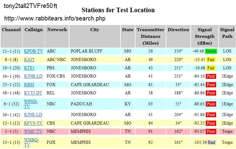

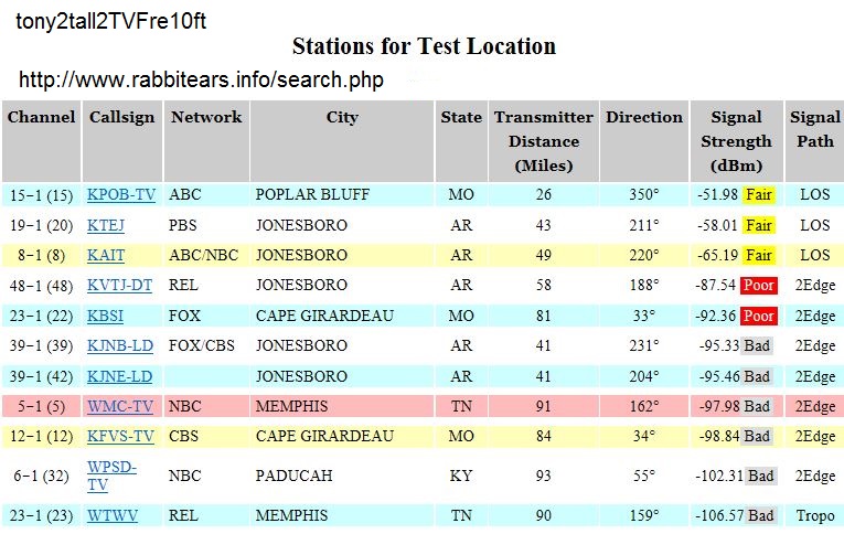

KFVS is not listed on the TVFool report because of a defective database, but it shows up on the RabbitEars.info report, and is very weak as ADTech says.
With antenna at 10 feet:
With antenna at 50 feet:

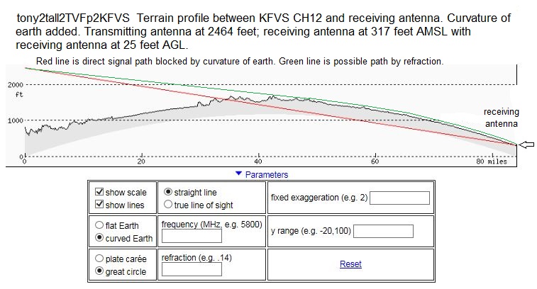

The main problem is the curvature of the earth:

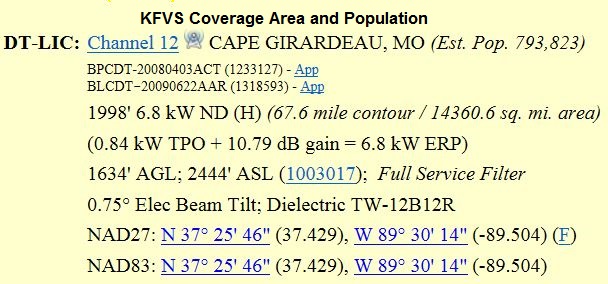

The digital signal requires less power than the analog signal for the same coverage area; it is more efficient. The goal was to maintain the same coverage area when switching from analog to digital, for the ads.
When a digital signal gets weaker, it drops out suddenly at a certain point. When an analog signal gets weaker, it gets more snowy, so we can watch it a little longer.
