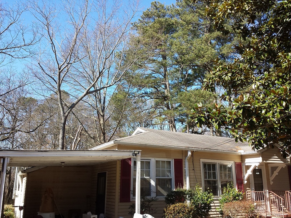

Trying to come up with a good setup for a new OTA. The main locals at the top, real 8 and to a small degree 22 are what I want to receive and I guess ION if it does not start to pose a problem. Being that everything is green I have been trying to hit some thrift shops to try and find some cheap 2 dollar rabbit ears just to see if thats all I would need. In the report I listed it at 15 feet as I have read people using two fencing poles driven into the ground to mount on and thought about that. I do not have attic space and am not wanting it on my roof as I would be doing it and don't really want it visible though am not completely opposed to it as it would cut a $70 cable bill with noting but digital starter from comcast. I have a tree forest to deal with in the back (read blocking all the channels I want), and a large magnolia in the front blocking channel 22. Attached is a picture showing the general direction of the main cluster of transmitters, channel 8 is roughly behind me taking the pic, and to the right is the magnolia tree.
EDIT: Just to add a little clarification, I had planned on putting the pole in the back as I said to keep some what hidden as I know it has to come over the roof to pick up other channels. I thought about the opposite end of house from the picture but then realized the magnolia tree is in the way. Maybe the other end or on the carport as its not used for car anyway and any screw up on install wont affect the inside of the house if height is needed.

Be prepared with an outdoor antenna, ION may not be doable. You have a mix of very strong to trending weak terrain obstructed signals. Normally for signals like ION's we suggest stronger gain antennas. However, with the strong signals from magnetic 215, a higher gain system isn't an option. If you installed that higher gain system, the very strong signals could overload your TV tuner. In essence, making it "blind" and losing reception either partially or completely. This happens when it is getting too much signal.
My recommended system would be limited to your extremely strong signals at magnetic 215. You don't want a strong, high gain antenna. I would focus on your locals and trying for RF 8 with an Antennacraft HBU11. http://www.solidsignal.com/pview.asp...ntenna-(hbu11). Orientate to about magnetic 160- 180. Play in that range to see what you receive.
Further, this antenna is small so it can be rather non-obstrusive. The HBU11K option (also sold by solid signal) includes a J-pole for mounting. I would mount it on your roof with the best path to magnetic 160 to 180.
The upshot of this writing though is that a high gain system for ION is probably a non starter due to very strong signals at magnetic 215. RF 8 you have a chance at. RF 22 is way off axis of everything else and may or may not be received. Luckily is has a decent signal so it may be received.
You'll just have to get something in the air, see what you get. But, realistically ION is off the table. The best chance of your non-magnetic 215 signals is going to be RF 8.

Sorry for the late night confusing post. Just think of me as one of those eww I don't want that on my roof kinda people. I have been reading threw the forum for several days so kinda knew (or at least thought) I would have to have it seen. So I have prepared myself for that. I have seen few in disrepair here and there wires just hanging down and trying to avoid a roof install to make upkeep easier and avoid falling threw also. I was planing on staking in the back yard getting it up high to see over the roof. My main concern started being how high to get it because of the trees. Especially in the next month or so when they start growing there leaves again, as I read somewhere on here that they tend to block UHF. I had the feeling as you said the cluster of locals should be strong enough (Even threw the tress?) so I was looking for something cheap to see my luck before purchasing something good (for the inside if it worked). I'm not concerned with over powering the receiver as it will be split to four devices and have a drop amp and 8way amp spliters should it be needed.
