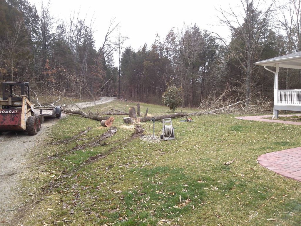

Generally, signals lost in the springtime are due to the leafing out of the trees. I've learned the hard way that investing in a good chainsaw (or a tree service) is going to yield superior results to swapping antennas around. As a matter of fact, I just cured my pesky summertime reception problems with local station KETC last Saturday.
