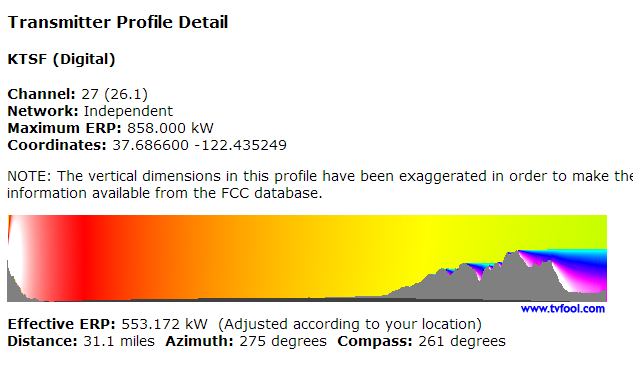

How to catch 26.1 from Pleasanton in East-bat
Hello all,
I am quite interested in receiving KTSF (26.1) from Pleasanton quarter mile south east of downtown. I bought Antennas Direct DB8e and just experimented with pointing in the direction, but no luck. I have attache the TVFools image and the image of TV tower details. Any thoughts? Of course it is all red, but looking to experience of others.
Also since DB8e is only a UHF antenna what do I do for VHF channels?
I am essentially trying to get, through antenna, what Comcast basic cable was pumping.
Please advice. Cheers.
aamitabh is offline   Reply With Quote

The terrain between your location and the San Fransisco transmitters is quite a challenge. Keep experimenting with antenna placement (including both high and low locations).

Install the antenna above the peak of the roof in such a manner that the roof and building are not , obstructing , impeding , blocking , reception in the directions of , north west , west , south south east .
Aim the UHF at about 261 degree magnetic compass direction.

KTSF is predicted to arrive at -1.0 db at your location. Your only chance at successful reception of the signal is outside, either on your roof or in another outdoor location.
It was said earlier in this thread and it bears repeating, the bay area in many places is awful for reception due to terrain. That is why AM radio (IE, KRFC 610, KCBS 740 and KGO 810) remained so dominant after FM radio had taken over: AM signals handled the terrain better.
Be patient, be persistent. If engineers of broadcast stations have been fighting the local terrain for years in your area, you know you aren't the first to be frustrated by those difficulties.
