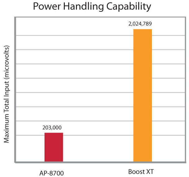

They also list its “Maximum Total Input (microvolts)” as “2,024,789”.
Since I have one local FM station on 99.9 MHz @ -13.4 dBm and a local TV station on RF channel 26 (24.1- .4) @ -15.6 dBm that overloads both my Winegard AP-2870 and HDP-269 models I had hoped this new amplifier would live up to its promise –so I bought one. Unfortunately, it didn’t!

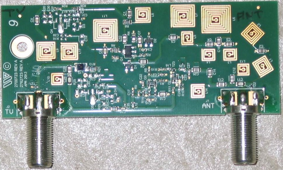

Removed from its plastic case, the circuit board measures 3 15\32” X 1 5/8”. The 1 5/8” grows to 2 5/16” if you measure to the ends of the ‘F’ connectors.
Front
Back
It appears to have three active amplifiers (Q1-Q3)
Closeup

Pete, thanks for the report and the images.
About the images.
Can you try to read any numbers or letters on:
Q1, Q2, Q3
D1 & D2
The numbers and letters on each device will likely be 3 characters
(such as 3F4, or something similar)
About the TZJ (cannot read for sure? it's above Q2),
Does it look like a diode?
And, TZ2 or T22 near the input connector, does it look like a diode? could be a transient protector?
Q4 and Q5, fairly sure they are regulators. Are they leaded components, like TO-92, TO-93 cases? If so, do you see any nomeclature?
A small flashlight and magnifying glass can be very helpful, also try lighting from different angles.
Thanks
Old 11-Sep-2013, 2:22 AM   #3
Pete Higgins
Pete Higgins's Avatar
Join Date: Apr 2013
Posts: 83
Re: Lna-200
tripelo,
I have a large 4 ¾” articulating magnifying glass surrounded by a florescent light. Even with that and a 2 7/8” hand held magnifying glass some of the writing is too small for me to read. A component in this amp marked the same as the components in my AP-2780 & HDP-269 marked with a centered red dot and Brown & Green dots at one end that I couldn’t identify are labeled L15 on this circuit board.
Q1, has N4 written above W36. Q2, the only thing I could read was 4F. Q3 looked like it might say 3L but I couldn’t be sure. My wife’s younger eyes saw the same thing.
D1 is marked A6.
D2 is marked 5D 3.
TZ1-3 are small components about the size of a fly speck! It doesn’t look like they are big enough to write on. TZ1 is by the power in/TV out connector and showed a front-to-back like a diode.
TZ2 is by the antenna connector and TZ3 is by Q2. With my eyes I couldn’t see to get a probe in to take readings on these two.
The pads marked Q4 and Q5 are covered over by solder –no components installed. In addition, they are surrounded by a number of unpopulated pads. Whatever was intended to populate these areas would have been surface mount because there are no thru-holes.

Winegard LNA-200 Components
Hi Pete,
The following is some guesswork based on your images and information.
It appears that the LNA-200 has two active amplifier devices.
The UHF portion is amplified by Q2, an ATF-54143. The ATF-54143 is an industry-standard pHEMT transistor. As a broadband amplifier, at TV frequencies it can readily achieve noise figures below 1 dB. It and most other pHEMT devices are very susceptible to transients Voltage (ESD or atmospheric discharge). It, or a very similar device, was used in the Kitz KT-200, and another low noise pHEMT-based TV preamplifier.
Q3 is a part of the bias regulator (current mirror) for the ATF-54143.
The VHF portion is amplified by Q1, probably an NPN transistor.
The TZx are Tranzorbs. Fairly sure TranZorb is a trademark name of the company that originated them. They are transient voltage suppression diodes. Tranzorbs are similar to Zener diodes, with some special characteristics for particular applications (probably low capacitance and such). These help protect the transistors (especially the ATF-54143).
D1 and D2 are signal diodes, one or both, could be involved in protecting the transistor Q1 from transients.
The component L15 is an inductor, Coilcraft makes similar, the dots indicate the amount of inductance. It is probably part of the power supply circuitry.
Some of the spiral PCB inductors are associated with the input and output diplexers. Like UVSJ, the diplexers separate VHF and UHF for amplification then recombine at output. Also, some spiral inductors are associated with the FM Trap.
Relating to the noise figure and signal handling capabilities:
- The spiral inductors used in the FM trap and the diplexers have lower Q than open-air wound inductors. Thus, they have more signal loss.
- The Tranzorbs and the diodes used for input protection also introduce losses.
Losses at the input contribute directly to the noise figure of the unit.
- The nonlinearities of the diodes and Tranzorbs may generate intermodulation products from very strong signals.
As evident in this preamplifier:
Preamplifier design often involves tradeoffs between low noise figure, ESD susceptibility, and signal handling capability.

I downloaded the data sheet for Q2, the Avago ATF-54143 and sure enough their data sheet says the 4F I read is the device code for that part. The date code character must have been too small for either my wife or I to read. You probably are also right about Q3’s function as well since their data sheet shows a schematic for an example active biasing ckt. and says “Active biasing provides a means of keeping the quiescent bias point constant over temperature and constant over lot to lot variations in device dc performance.”, both of which would be essential in a production design intended for outdoor use.
I thought at first Winegard might be advertising the UHF amplifying device NF instead of the overall amplifiers NF but the ATF-54143 data sheet lists a 0.5 dB overall noise figure for the device and depending on drain-to-source voltage and current less than half that across the UHF TV band, so that’s not it. Also, in his less than pristine environment, ADTech found a 2.8 dB average NF on UHF for the LNA-200 which is slightly worse than the 2.6 dB he found for the RCA TVPRAMP1R he tested. Do you think his environment could be contributing a noise floor or NF threshold?
Avago’s data sheet also says that “The device can handle +20 dBm RF Input Power provided IGS is limited to 2 mA”. I’m not quite sure how to interpolate that number in terms of Winegards advertised “Maximum Total Input (microvolts)” of “2,024,789” which in a 75 ohm system, I calculated to be a signal level of about +17.38 dBm unless they are being a little conservative with this rating (~½ the power ?). And, given both of those numbers, I don’t understand why I was seeing what appeared to be overload. I assumed that overload was creating spurious responses that raised the noise floor above my channel 31 (5.1-.3) MDS signal level. That was definitely a characteristic of the LNA-200 when hooked to two different antennas because in both cases when I replaced it with one of the RCA’s I got the channel back. I don’t think it was the gain differential because when I was using the +15 dB PCT MA2-M’s I always got channel 31.
About the only thing I think I do understand is getting my local TV station with the antenna pointed to San Diego. The RCA’s are shielded and the Winegards are not.

The device can handle +20 dBm RF Input Power provided IGS is limited to 2 mA”. I’m not quite sure how to interpolate that number in terms of Winegards advertised “Maximum Total Input (microvolts)” of “2,024,789” ..
That's interesting. without doing any looking at the data sheet.
That maximum total input appears to be the instantaneous Volts the device can sustain without failing. It seems much more than the device can handle in a linear fashion (without IMD and harmonic distortion).
If it linearly amplified 2 Volts, the output could be 20 Volts. Not likely with a 3+ Volt supply.
...which in a 75 ohm system, I calculated to be a signal level of about +17.38 dBm unless they are being a little conservative with this rating (~½ the power ?).
Winegard's Transzorbs and diodes are probably set up to limit input Voltage for some margin of safety.
