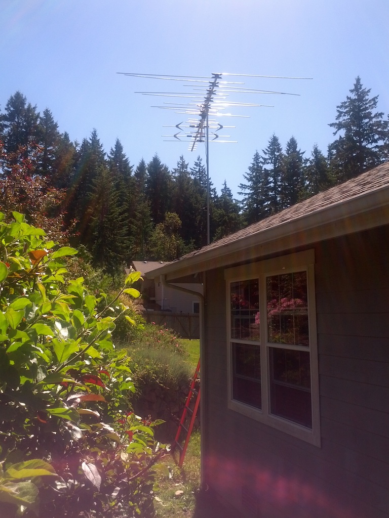

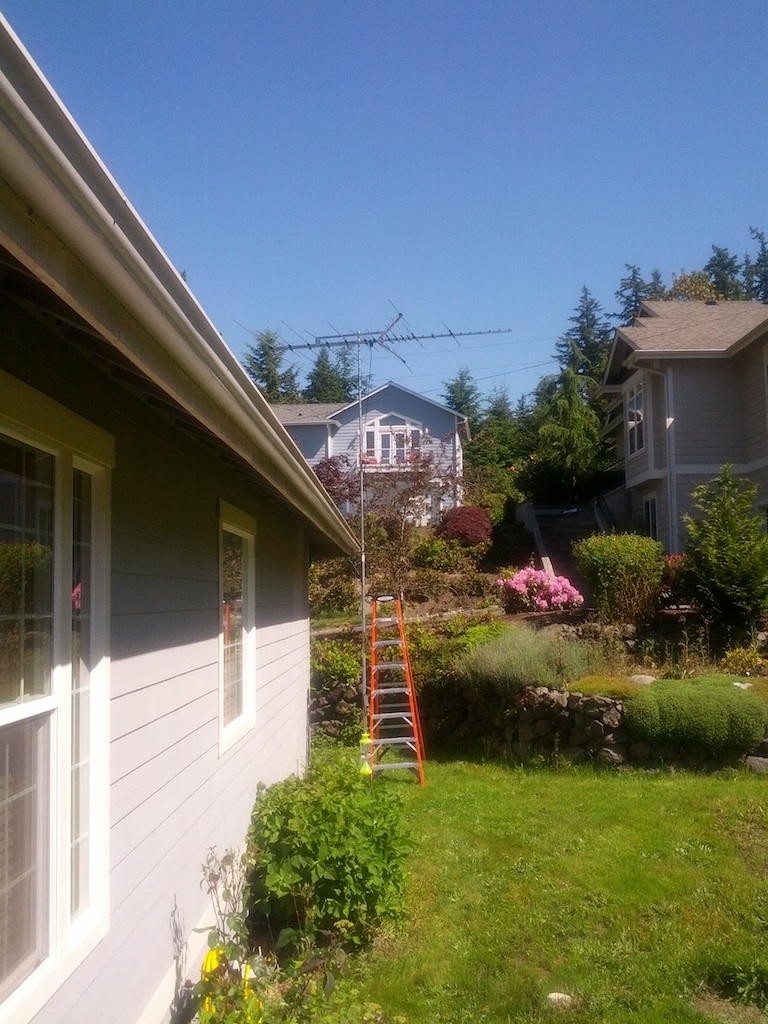

How far is the antenna above the roofline? Any metal nearby? Have you experimented with aim, or are you relying on a compass for aim? Can you possibly take a photo of the antenna where it is mounted?

I've attached a couple photos.

The operative word for the antenna at your location is-->Higher.
Higher as in-->Higher above ground.
Up High.
Here is a Higher antenna mount , install above the High part of the roof. http://www.ronard.com/Tripods%200703/4712.html.
The -->Only Way<-- to find how much reception is improved is to install the antenna-->Up Higher above ground.
Last edited by teleview; 5-Jun-2013 at 3:49 AM. Reason: Clarify information and typos.
