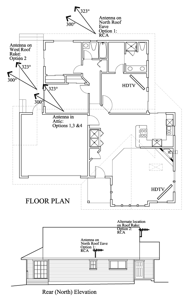

My house is a single story stud construction. There is a two-story house about forty-feet away to the north and mature trees in the signal path. I'm in a valley with the Siskiyou mountains to the north.
I'm considering the following antennas:
Option 1: RCA Ant 751 because its uni-directional and I could install it "outside" either on the north facing roof eave (about 8-feet above grade) or somewhere along the west facing roof rake (about 10 to 15 feet above grade).
Option 2: RCA Ant 751 installed in my attic space (10 to 15 feet above grade).
Option 3: Winegard 7694P (65" boom) installed in my attic space.
Option 4: Antenna Craft HBU 33 (85" boom) installed in my attic space.
(See attached antenna location floor plan below.)

Your location has receivable Digital Broadcast Tv stations/channels in All 3 Broadcast Tv channel bands.
VHF low band channels 2 thru 6.
VHF high band channels 7 thru 13.
UHF band channels 14 thru 51.
Above the -->Peak<-- of the roof install a Winegard HD7000R All Channel antenna in such a manner the roof and house are not blocking reception to the , north west and south.
Aim the HD7000R antenna at about 305 degree magnetic compass direction.
For 1 Tv connected use No splitter. No amplifier.
For 2 Tv's connected use a simple common 2 way splitter. No amplifier.
For 3 Tv's connected use a simple common 3 way splitter. No amplifier.
Here are some places to buy antennas and etc. , http://www.solidsignal.com , http://www.amazon.com , http://www.winegarddirect.com.
Here are some above the roof antenna mounts ,
http://www.ronard.com/909911.html , if using a tripod antenna mount use the 5 foot antenna mount.
http://www.ronard.com/34424560.html , if using the eave antenna mount use the #4560 mount.
http://www.ronard.com/ychim.html.
http://www.ronard.com.
Buy the ronard antenna mounts at solidsignal by typing the word ronard in the solidsignal search box or buy from ronard.
________________________________
As always , trees and tree leaves do a good job of , reflecting , reducing , blocking , Digital Tv reception and so do buildings and other obstructions including your own roof and house.
It is best to install the HD7000R antenna at a location that has the least amount to no amount of obstructions of any type or in the directions of reception including your own roof and house.
