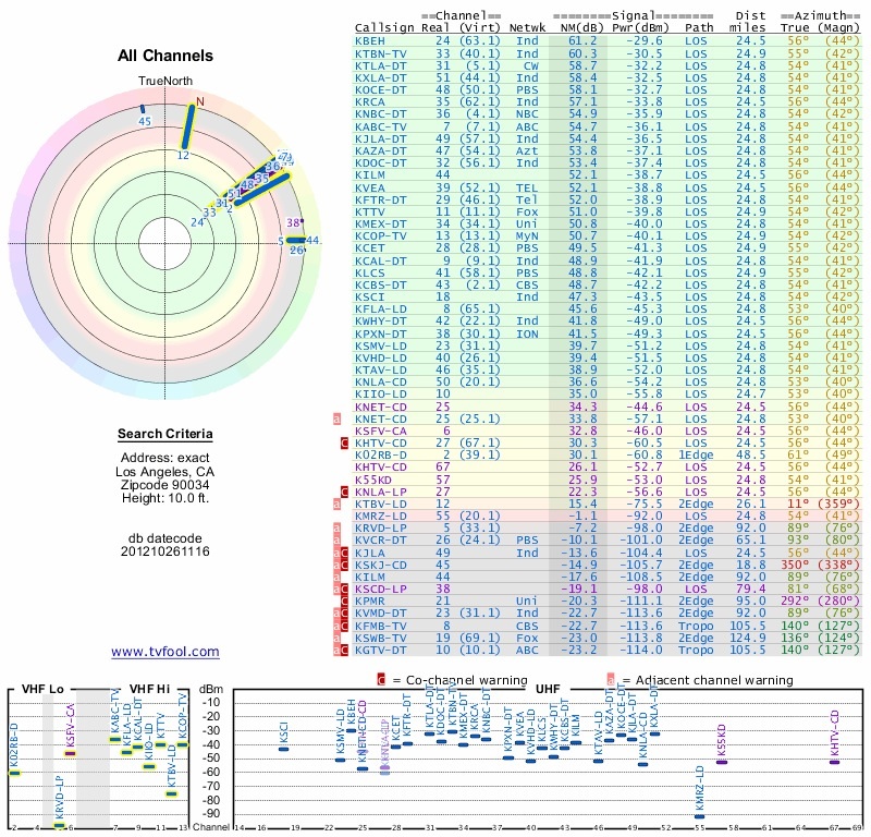

I would like to get OTA channels. I live in an appartment so outdoor antenna is not possible. Based on my signal : http://www.tvfool.com/?option=com_wr...cc4963986f707d - Do I need amplified indoor antenna (like Terk HDTVa) or non-amplified (like Mohu paper thin leaf). I understand the sometimes amplification can induce more noise, but I need channels - CBS, ABC, NBC in good quality. Please help as I am a newbie.

There are Many Strong LOS = Line Of Sight Tv transmitters to the north east.
If the building is wood with wood or vinyl siding then install a TERK HDTVi non amplified antenna , (not the HDTVa amplified antenna).
A amplified antenna will most likely make reception Worse because the Tv signals Are VERY STRONG at your location , will likely over load a amplified antenna and the Strong multipath - reflected signals bouncing all around in your apartment and in the building will likely overload a amplified antenna and overload the Digital Tv tuner and the Digital Tv tuners computer will shut down some overloaded channels that are to much for the Digital tuners computer to process.
Aim the HDTVi at about 44 degree magnetic compass direction.

While a poll is not needed, It doesn't hurt anything. My enthusiastic and certain vote has been cast, non-amplified.
I would expect the non-amplified HDTVi to do well. The 'CS2 Complete' would be an excellent choice also.
