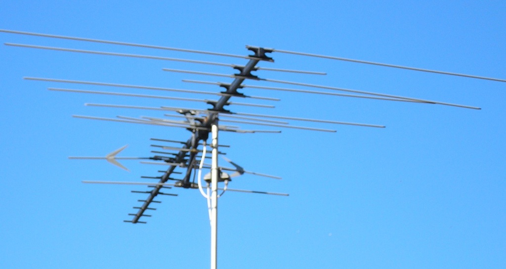

Also I have attached two pictures of my current antenna. I am not sure how good of antenna this is. I think for Milwaukee it would be fine, not sure about Chicago It appears to have either an amp or preamp on it, the short coax from the antenna runs into the amp/preamp and then the second coax runs outbound from the amp/preamp into the house. I think for Chicago an amp would probably be needed, not sure how old that white coax cable is, may need a brand new one fed in.

That appears to be a Winegard HD7082P. It appears to be intact, with only a small amount of sagging or bending of a few elements. If there are no other problems with it, it should be more than enogh antenna for the Milwaukee signals. Aimed at about 20° compass, you can remove the preamp and expect to have plenty of signal to drive a passive 4 or 8-way splitter. If you are going to connect three sets, use a 3-way splitter.
http://www.winegarddirect.com/pdf/spec_HD7080P.pdf
Actually, rather than saying 'can remove' I am inclined toward saying 'you really ought to remove the preamp'. You have so much signal power to work with, many preamps would overload, leaving with lower quality signal.

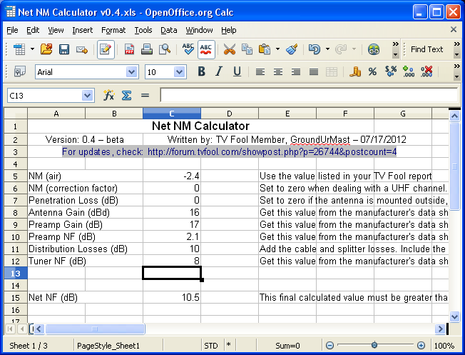

As far as Chicago is concerned, some signals are within reach if you use a large high gain antenna. I'm thinking a Winegard HD9095P or an Antennas Direct 91XG equipped with the Antennas Direct CPA-19 preamp.
The 9095 claims 16 dBd gain at CH-32. When I estimate the net NM of the signal from WFLD-Fox I get a good number, +10.5 dB. (see attached)
Can you mount higher? If so, it would be interesting to see a TV Fool report for 40' or even 60'.
