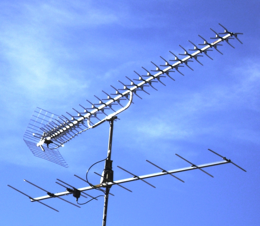

The TV FOOL report shows sufficient signal strength at your location for reliable reception of RF 24. Have you ever tried tweaking the antenna height up & down in small increments? (around 6 inches) Also, if you are pointed directly into any obstacles at fairly close range, the antenna may require aiming off axis for a reliable signal on that particular channel.
The other thing that comes to mind is the 7777 preamp may be at risk of front end overload, but with the antenna aimed at 74°, I think you are safe. You may want to try hooking 1 TV straight to the preamp (no splitter) to see if that improves 24.
If nothing you try improves 24 to a watchable level, you may want to extend the 91XG. ($25.00 from Antennas Direct) I have found that to reduce multipath interference & improve reliability with problem channels.

@No static at all: When you say to extend the 91XG, are you talking about putting the antenna on a longer pole or add the extra antenna that you displayed in the picture?

You can add a middle section to the 91XG that will provide a small gain increase, but more importantly can help tame multipath if that is a problem. You should be getting all of the yellow coded stations with the set-up you have.

The Accessories on the Antennas Direct 91XG site show a Mast Extension, but I can't find this middle section. Where did you get yours from?
