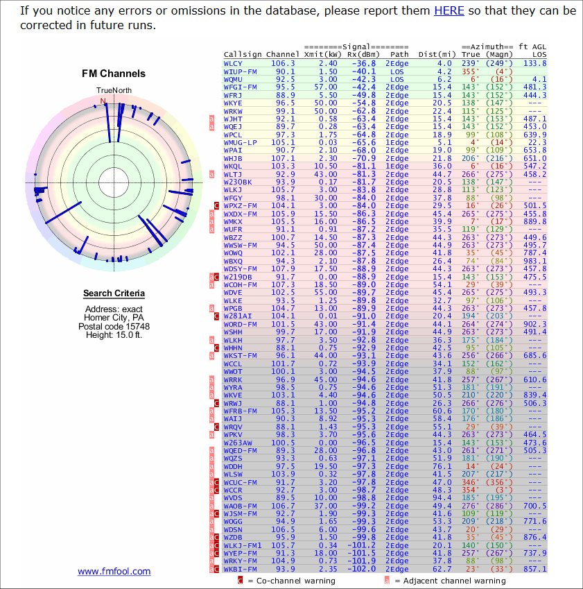

FM Fool signal plot is as follows:
I'm aiming to get the weaker signals, mainly the greys. The Pittsburgh FM's (red area) come in clear enough most days inside.
I only have 92.5 and 106.3 as for local signals for possible overload.
Bottom line: Am I better off with a preamp, vs a distribution amp for my situation?

Image attached.
I was thinking the LNA200 had a switch for the FM trap, must of been another model I looked at.
I ran a test inside with the 92 feet of RG6, and without F connectors, I had present static where the static was barely before, so this was my reasoning for a preamp or dist amp.

LNA200 has no switch, the trap is always in. The CM777x and the RCA preamps do have a switchable trap. However, like I already said, you likely do not need and should not use a preamp.
Install your F-connectors properly. The test you did is invalid due to improper terminations.
