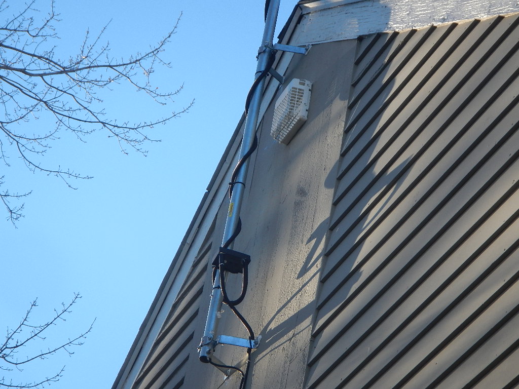

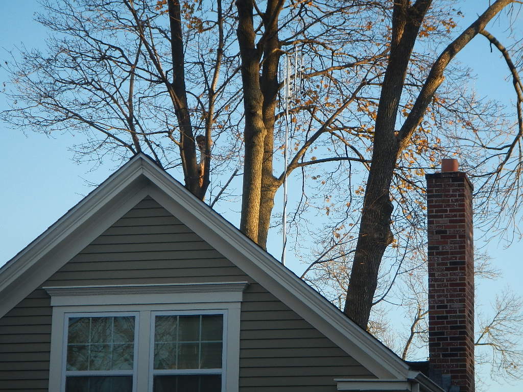

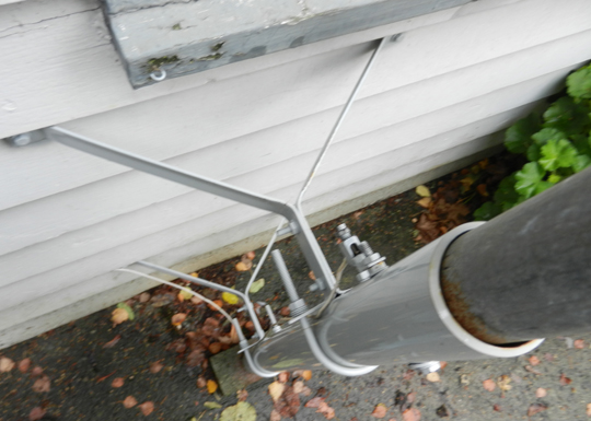

I've attached 3 photos. The 1st shows the antenna and its direction, the 2nd and 3rd show what it's aiming towards, unfortunately the camera shots have been taken at ground level and it's hard to get a good long-view. There's light tree vegetation in adjacent yards and a condo a bit off to the side of where the antenna has been aimed. I believe that I am somewhat in the low part of a valley.

Thanks for the photos. I would like to give you an idea that would guarantee an improvement, but I can only suggest things that might help:
1. Raise the antenna
2. Try a different preamp
3. Insert a UVSJ before the preamp to block any VHF interference
4. Consider the possibility of cell phone interference
I realize that you can't do much about the trees and the mounting locaton.
Maybe ADTech can suggest something I overlooked.

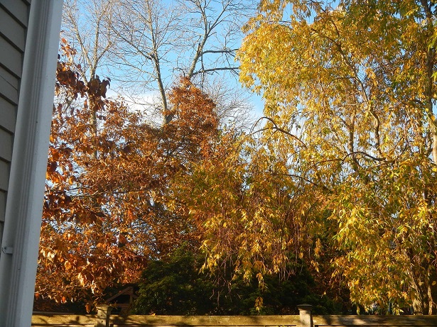

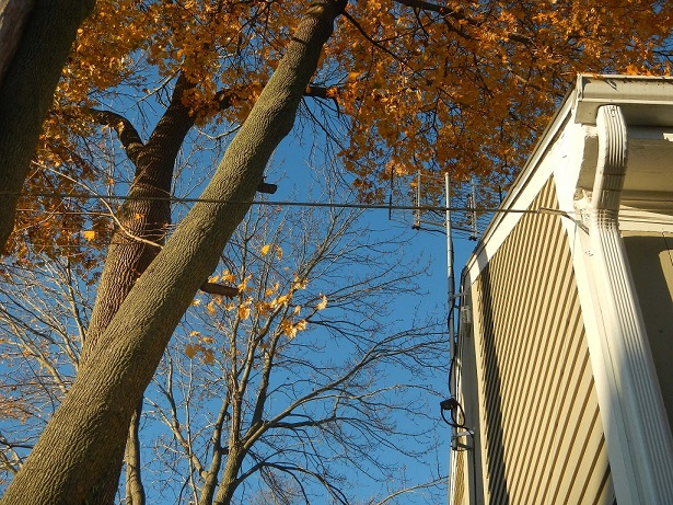

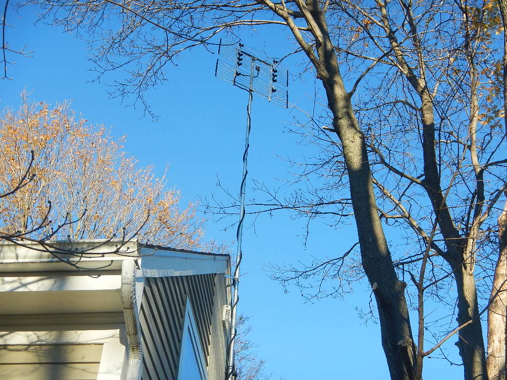

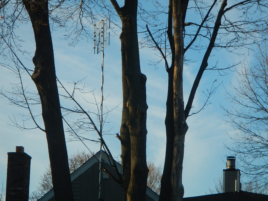

I had the antenna installer back out. He raised the antenna by about 5.5' (see photos). Voila! Excellent reception, including WSBK and WLVI. Only very isolated pixilation has been observed since then. (Note: he originally raised it by 5', but it was found that 5.5' reduced pixilation even more)
OK great! But I now fear another problem. The antenna is unsupported by guy wires and I saw it swaying in the wind a few inches when the winds were about 16 MPH. I fear that the pole will snap or, even worse, become a projectile during a major windstorm.
I believe that the installer said that he has a 1.5" pole inserted about 4.5' into the originally-installed 2" pole. The supports attached to the condo are very solid wood so I'm not concerned about the supports popping out. The installer said that 4 points would be needed for guy wires (and didn't put in any), we probably really only have two points (?) available, both on the roof. The adjacent trees certainly can't be used as they sway even more than the antenna.
I'm afraid that I'll have to get guy wires installed. The expenses are beginning to add up to where I probably should've stayed with Comcast
Is it agreed that I'd better either get guy wires installed, OR lower the antenna and put up with worse reception? Thanks, this forum has been helpful to me, especially from rabbit73!

Old 18-Nov-2015, 1:27 AM   #20
Thanks for the new photos; they tell us a lot.
I'm not a PE who could make wind load calculations, but I'll give you my thoughts.
That seems to be further proof of signal layering.
I understand your concern. How is your liability insurance?
That sounds conservative.
That would be ideal, but it doesn't look possible.
Two points would be enough if you use braces instead of cables.
Antenna Mast Stabilization - Guy Wires V's Rods
http://forum.tvfool.com/showthread.php?t=15836
That wouldn't have been as much fun and wouldn't have gotten your creative juices flowing to meet the challenge. I sometimes have buyer's remorse from the money I have spent on antenna experiments and measuring equipment, but my life has been richer for it. If you had not tried, you would have always wondered. I consider it money well spent.
Some things you might consider:
1. Mount two braces from the roof to the mast. Add pitch pads because of roof penetration; a job for a roofer
2. Use a tripod mount on the roof. Add pitch pads because of roof penetration; a job for a roofer
3. Replace the mast with one more rigid
4. Move the upper bracket a little higher and add a third bracket between the two to reduce the sway
5. Replace the 8-bay antenna with a 91XG which has, I think, less wind load
6. Hire a PE
