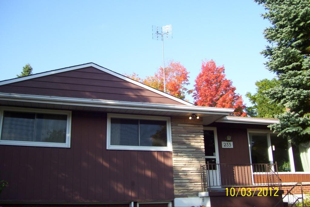

Grounding your antenna
I've installed two roof antennas and grounded them by connecting a heavy gauge wire form the base of the antenna to the copper vent pipes that run through the attic from the plumbing system. Just use a worm gear clamp around the mast and the vent pipes. I have a photo, but I can't see to upload it here.

Here are some photos of my roof top antenna with a grounding wire in the attic. The copper wire at the base of the antenna mast attaches to the copper vent tube that runs to the roof through the attic (in a 55 year old house). Check to ensure that the vent tube is firmly grounded before connecting the wire. I found that a firm grounding of antenna mast gave a better reception as well. The black coaxial cable runs through the center of the mast to the TV connection downstairs.
