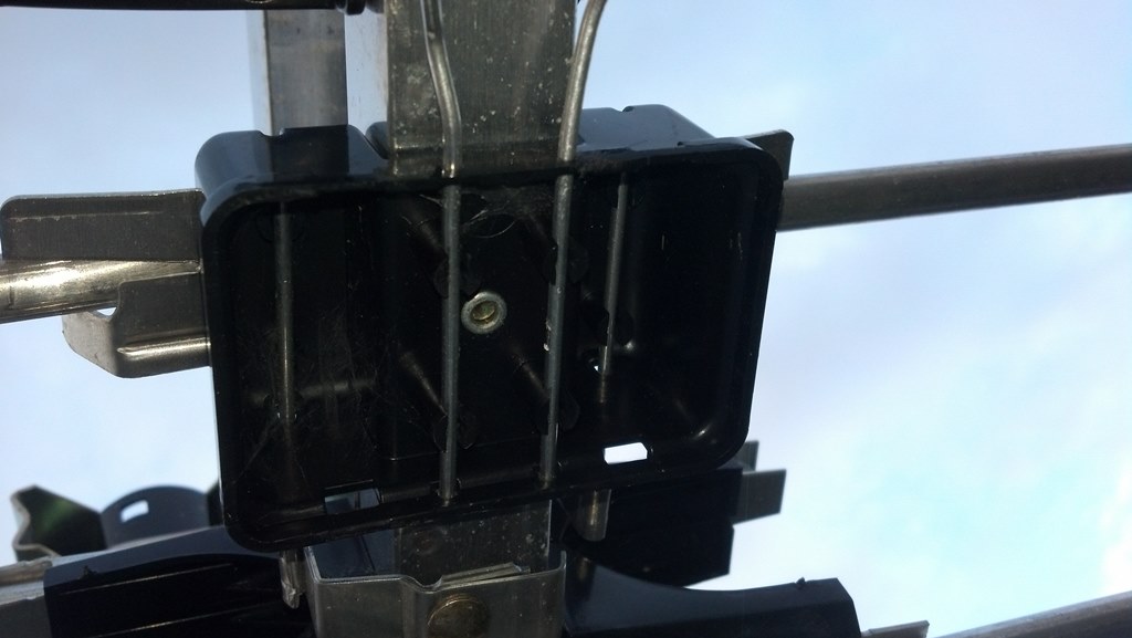

Pictures of the phase
Here are the pictures as promised, sorry for the delay and thanks again for all the help. The metal is not touching anything except the clips in the plastic box and the inside looks dry. The tree I'm aiming through has no leaves right now so I'm hoping to get the best results this time of year and deal with less channels when the leaves come back. Please let me know if you can't view the pictures.

Picture # 1 , looks like the phasing line wire might be touching the metal bracket that holds the < shaped UHF channels reflector.

It may look like that in the picture, but it isn't...
