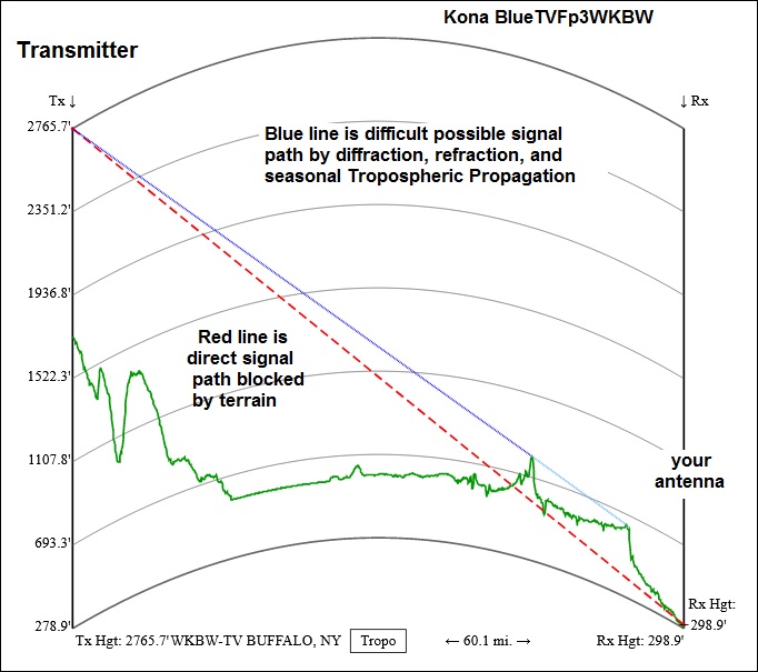

Just so I have this right and I am asking the question again due to confusion at my end, but are you still saying that I cannot combine the 91XG and the ANT-751 to use only one down feed wire?
Tower Guy is correct. CBS, ABC, and NBC are very weak and blocked by terrain.
https://www.rabbitears.info/searchma...tudy_id=231919

The HW-150 will allow you to add a channel after a scan using the Manual Search window in the menu. This keeps you from having to rescan over and over again when hunting for a missing channel.
