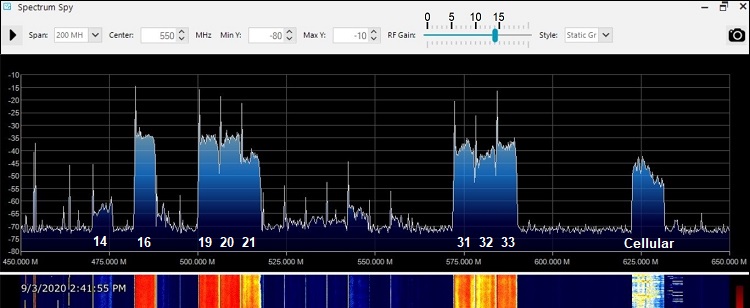

You would only need an LTE filter if you had strong local cellular signals that are causing interference.
I have cellular/LTE signals where TV channels 39 and 40 used to be, but they are not strong enough to cause interference.
Video to show cellular activity at right end of scan:
