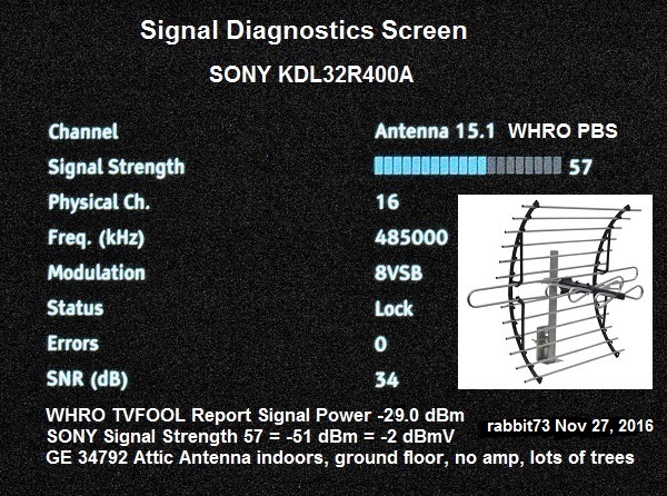

Another difficult location. You will need to do some testing to see what will work.
I have had good luck with a GE34792 Attic Antenna that was on sale (assembly required).
http://forum.tvfool.com/attachment.p...1&d=1482801005
https://www.youtube.com/watch?v=1qYucg3JXzA
WBBM CBS will probably be too weak because it is on VHF channel 12; that antenna and mud flap antennas are better for UHF than VHF.
