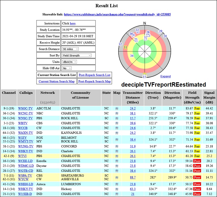

Thanks for the report. TVFool is using an old database to generate reports, so I did an estimated report for your location using rabbitears.info:
https://www.rabbitears.info/searchma...tudy_id=253085
https://forum.tvfool.com/attachment....1&d=1619741177
You can do a more accurate report for your location at this site (I use coordinates from Google maps):
You have a few signals that should be OK with an attic antenna but they are not all in exactly the same direction.

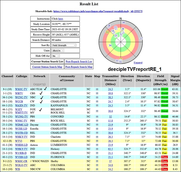

What channels do you need (by callsign) and what channels are you getting OK now?
Please do a signal report for you location at rabbitears.info using the coordinates of your antenna.
Even better, are you willing to give me your address and coordinates of your antenna from Google maps in a PM for privacy, so that I can see how the signal lines reach your antenna?

Thank you for the signal report. It gives me a better idea about how the signals arrive at your antenna in the NW end of the attic.
Only the ABC affiliate is coming in poorly. The quality is at about 45% to 50% and it's very spotty reception.
That is to be expected. WSOC is coming from a different direction (the North) and there are many trees in the signal path that weaken the signal and reduce its signal quality.

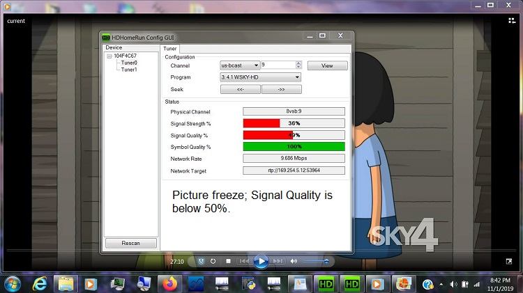

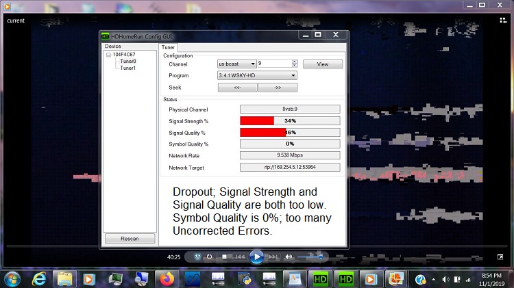

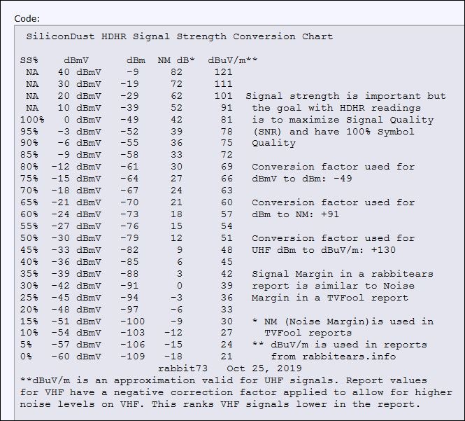

The HDHR GUI can be very useful; it gives Signal Strength, Signal Quality, and Symbol Quality.
When the Signal Strength reaches 100%, that is equivalent to 0 dBmV (-49 dBm). That's about the level antenna installers and cable guys aim for at a wall plate outlet for a TV. However, TV tuners can handle signals much stronger than that without a problem. But if you talk to a SiliconDust tech, he will tell you that you have overload at 100%. It seems that HDHR tuners have a tendency to overload more easily than TV tuners.
Signal Quality, which is similar to SNR, must be at least 50%. This is equivalent to about an SNR of 15 dB.
Symbol Quality is the inverse of Uncorrected Errors. 100% Symbol Quality is no Uncorrected Errors. You must have 100% Symbol Quality for reliable reception.
I did a thread about that topic:
SiliconDust Signal Strength Conversion Chart
https://forum.tvfool.com/showthread.php?t=16691
https://forum.tvfool.com/attachment....8&d=1620166586
https://forum.tvfool.com/attachment....9&d=1620166673
https://forum.tvfool.com/attachment....0&d=1620166735
https://forum.tvfool.com/attachment....1&d=1620166783
Now that you mention it, we did have some storms pass through the area earlier in the day yesterday. It may still have been a bit windier than usual when I tested in the evening
When the wind blows, the tree branches sway, which chops up the signals passing through.
I have a tree outside my window that messes with the signals when the wind blows, causing increased signal errors.

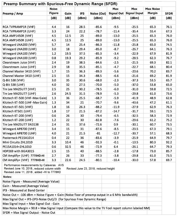

Thanks, I will have to observe and test over the next few days. Do you happen to know the signal/noise ratio on the RCA? I searched but didn't find anything.
Preamps are not rated in SNR, they are rated in Gain, Noise Figure, and MAX Input. Your RCA amp probably has a gain of about 12 dB, but RCA doesn't publish those specs.
https://forum.tvfool.com/attachment....3&d=1620167429
