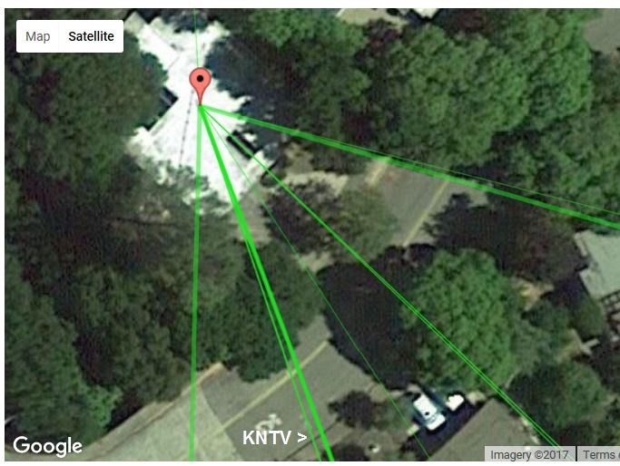

It appears my sight line to Sutro Tower goes right through a Extenet Micro Cell tower along a public road. I have email to Extenet about my TV reception concerns.
The HDTC-2US reports unlabeled "auto" Signal Strength
of 70% on RF 58 , RF59, RF 60 and RF 61.
When I point the 91XG 15 degrees off line of Sutro
RF 44 Signal Quality improves.
But RF 29, RF 43 and RF 45 Signal Quality goes down :(
(left of redwood tree to ridge)

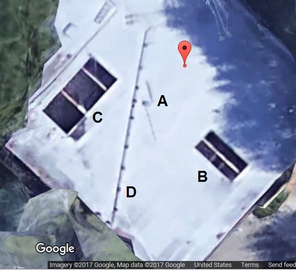

My best roof location can point left or right of the big redwood tree.
When I get a better mast I will try adjusting the antenna height. Will 6 inch increments
be a good starting place ? Maybe I will go back to pointing right of the redwood tree with height adjustment. I read the articles on stacking identical antennas to manage multipath
interference. That will be a last resort.

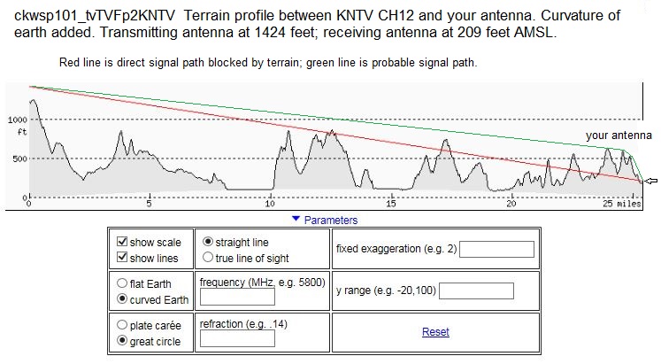

I'm using an AntennaCraft Y10713 on a separate saw horse to receive KNTV (NBC) RF 12. During a sunset bad reception event Symbol Quailty drops to zero. Signal Quality 46.
Signal Strength 78.
`pwd`/hdhomerun_config 10519452 get /tuner1/debug
tun: ch=auto:12 lock=8vsb:207000000 ss=78 snq=46 seq=0 dbg=-5700/-8984
dev: bps=19885888 resync=0 overflow=0
ts: bps=19885888 te=1976751 miss=87041 crc=0
net: pps=0 err=0 stop=0
During the above event RF 7 comes in fine. I'm guessing RF 12 interference.
Here is RF 12 good daytime readings from SiliconDust HDTC-2US. The Y10713 aimed
towards San Bruno. During good reception Y10713 has good directivity. Best signal
strength pointing towards San Bruno Mountain (transmitter location).
Virtual Channel none
Frequency 207.000 MHz
Program Number 3
Modulation Lock 8vsb
Signal Strength 80%
Signal Quality 54%
Symbol Quality 100%
During the RF 12 bad reception event changing aim of Y10713 did not improve Signal/Symbol Quailty.
I will need a longer cable to try different roof locations for the Y10713.
I have a second Y10713 on order from Solid Signal :D
That way I have option to experiment with stacking to address possible multipath interference. I don't need additional gain.

rabbit73 6-Oct-2017 3:03 AM
4 Attachment(s)
Thanks for the oblique satellite photo; it helps.
Here is the KNTV terrain profile:
http://forum.tvfool.com/attachment.p...1&d=1507254314
Is the antenna here (I used the vertical instead of the oblique):
http://forum.tvfool.com/attachment.p...1&d=1507255080
or here:
Is the antenna at the teardrop or at A.
Are B and C solar panels? Thermal or PV?
Do you have an inverter? They can cause interference on VHF.
What is D?
ckwsp101_tv 6-Oct-2017 5:17 PM
Antennas placed at the tear drop.
At this position UHF channel reception is fine.
VHF RF 12 gradually degraded over the last 6 months.
I can view alternate KNTV NBC 11.3 on RF 49 from Mt Allison San Jose.
B and C are open areas.
D is over the roof copper water pipe repair done 10 years ago.
Nearby houses do have roof solar systems. I would expect panel interference
to be greater during the day and less during the night. I will take more measurements
using the SiliconDust diagnostic program.

rabbit73 6-Oct-2017 9:11 PM
Thanks for the details.
Looks like the signal path is between two trees.
Tree growth?

Considerable improvement with horizontal array, but you are still behind a hill.
https://forum.tvfool.com/attachment....5&d=1571790151
Very true.
I did not realize magnitude of RF 12 multi-path interference at my location.
The horizontal array is a big win.
Reception fine most of the time.
