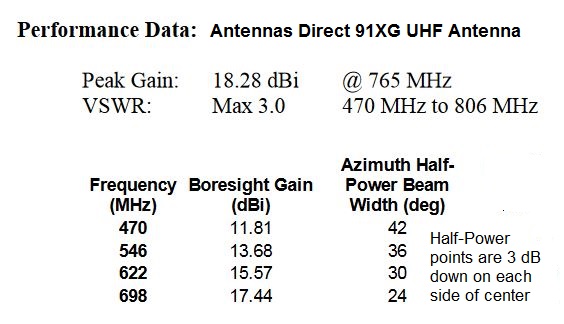

Solid Signal's claim of a 60 degree beamwidth for the HDB91X is misleading. They are not using the conventional method of calculating beamwidth. Some people will fall for it.
Technical Specifications
Beam width approximately 60° wide (out of 360°)
https://www.xtremesignal.com/portfolio-item/hdb91x/
https://forum.tvfool.com/attachment....8&d=1552497565
https://forum.tvfool.com/attachment....4&d=1552486831
Note that Winegard also uses the -3 dB half-power points to calculate the beamwidths of the 8200U:
https://forum.tvfool.com/attachment....5&d=1552487120
https://forum.tvfool.com/attachment....7&d=1552496752
You can have an antenna with more gain and narrower beamwidth or an antenna with wider beamwidth and less gain, but you can't have an antenna with more gain and wider beamwidth; the two are mutually exclusive.
Additional gain comes from making the antenna more directional with a narrower beamwidth, which ignores other directions like a searchlight or spotlight. There is no free lunch.

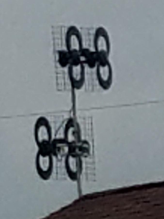

Funny, I was driving through Kenosha WI, I saw this array:
http://forum.tvfool.com/attachment.p...1&d=1552625490
I know it's not the MAX, but someone got crafty. Actually, I've seen a few of these array near the state line as you say.
And, I thought I saw two C4MAX's combined, somewhere. Easily distinguished by no reflectors, correct?
I always thought they were novelty antennas and overlooked them.

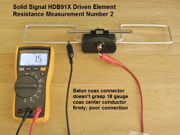

There is one thing I don't like about the Solid Signal Xtreme Signal HDB91X. The coax connector on the balun doesn't make good contact with the center conductor of the coax; it doesn't grasp the wire firmly. I noticed that when I was making resistance measurements of the driven element. I consider that a design defect. I inserted a short length of 18 gauge wire in the connector to make the measurement, which is the same gauge as the center conductor of RG6 coax.
https://forum.tvfool.com/attachment....5&d=1552676755
https://forum.tvfool.com/attachment....6&d=1552676901
https://forum.tvfool.com/attachment....7&d=1552677078
https://forum.tvfool.com/attachment....4&d=1552657281
