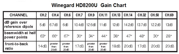

rabbit73 13-Mar-2019 2:56 PM
4 Attachment(s)
Solid Signal's claim of a 60 degree beamwidth for the HDB91X is misleading. They are not using the conventional method of calculating beamwidth. Some people will fall for it.
Technical Specifications
Beam width approximately 60° wide (out of 360°)
https://www.xtremesignal.com/portfolio-item/hdb91x/
https://forum.tvfool.com/attachment....8&d=1552497565
https://forum.tvfool.com/attachment....4&d=1552486831
Note that Winegard also uses the -3 dB half-power points to calculate the beamwidths of the 8200U:
https://forum.tvfool.com/attachment....5&d=1552487120
https://forum.tvfool.com/attachment....7&d=1552496752
You can have an antenna with more gain and narrower beamwidth or an antenna with wider beamwidth and less gain, but you can't have an antenna with more gain and wider beamwidth; the two are mutually exclusive.
Additional gain comes from making the antenna more directional with a narrower beamwidth, which ignores other directions like a searchlight or spotlight. There is no free lunch.

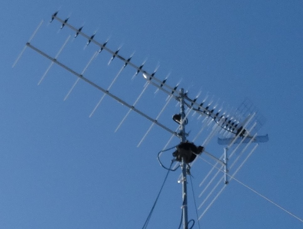

bobsgarage 15-Mar-2019 5:32 AM
C4max ?
2 Attachment(s)
Originally Posted by ADTech (Post 60891)
I can tell you that, in my more than ten years with Antennas Direct, I've had to replace the reflectors on exactly on 91XG. Ironically, it was my own antenna installed on a home that I sold a couple of years ago. A tall, spindly oak tree about 30' from the house came over and slapped the tail end of the antenna during a windstorm.
BTW, your location per the chart, is ideal for one of our C4MAX antennas. Bi-directional right out of the box. I've been recommended reflector-less C2V and C4V antennas for your area along the state line for a long time with very good results.
Removing the reflectors eliminates about 3 dB of insertion loss from using a splitter as a combiner plus the problems with phase cancellation is eliminated. The potential drawback is an increased susceptibility to multipath.
AD Tech, thanks for the great advice.
I haven't had the chance to see how bad the damage is to my XG91, I just see the reflector hanging, I guess by the coax? So far good reception.
http://forum.tvfool.com/attachment.p...1&d=1552623615
I'll look into the C4MAX. They look like the windload is low.

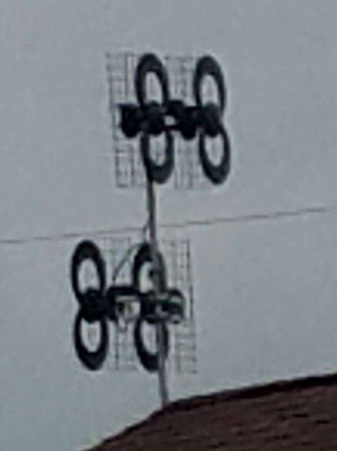

Funny, I was driving through Kenosha WI, I saw this array:
http://forum.tvfool.com/attachment.p...1&d=1552625490
I know it's not the MAX, but someone got crafty. Actually, I've seen a few of these array near the state line as you say.
And, I thought I saw two C4MAX's combined, somewhere. Easily distinguished by no reflectors, correct?
I always thought they were novelty antennas and overlooked them.

Nice shot Bob; just like I was up there at the antenna!
http://forum.tvfool.com/attachment.p...5&d=1553613743
Hi Rabbit!
Hindsight being 20-20, I think I would have done a nicer job on the video. But then again, it kind of shows the perspective which is what I wanted. In the video the antennas are actually pointed opposite of the way I normally have them. In the video they're pointed at Milwaukee actually.
That's to say that Chicago is directly behind that tall fresh green maple tree opposite of the point of the antennas. That tree is gotten substantially larger by at least four or five feet I think. Still, reception has been good with the XG 91 even with the reflectors still hanging and the 30 - 2476 is kind of a waste because we only have one VHF High channel in Chicago.
But you're right, it does put you right up there with the antennas and even gives me that queasy feeling because I'm somewhat afraid of heights. I have a difficult time looking down when I'm up high, even the video gives me that feeling!

I use the antenna Direct 91xg!!!
And the best 8200u

Hello and Good Morning AD Tech.
If there's really no difference between the C4MAX and the CS4V, wouldn't the old CS4V be a better deal ? (At least at Amazon)
http://forum.tvfool.com/attachment.p...1&d=1553867169
http://forum.tvfool.com/attachment.p...1&d=1553867267
When I scroll through the pics, the main difference (I see) is there appears to be casing over the middle frame. Is that for weatherproofing?
The other difference (I see) is obvious. The reflectors are on the CS4V, should I ever need them.
The price difference is minimal, but when you add on the reflector kit to the C4MAX, it's greater. Your opinion (and other's as well) is appreciated.
Thanks, Bob
