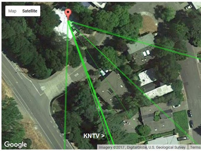

ckwsp101_tv 5-Oct-2017 10:34 PM
1 Attachment(s)
Here is current antenna location on tripod.
https://forum.tvfool.com/attachment....9&d=1507238477
I guess growing trees degrading VHF reception.
Will try to trim tree limbs on my property.

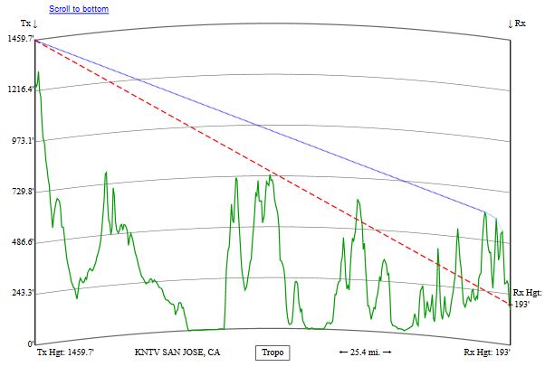

rabbit73 6-Oct-2017 3:03 AM
4 Attachment(s)
Thanks for the oblique satellite photo; it helps.
Here is the KNTV terrain profile:
http://forum.tvfool.com/attachment.p...1&d=1507254314

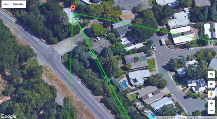

Is the antenna here (I used the vertical instead of the oblique):
http://forum.tvfool.com/attachment.p...1&d=1507255080
or here:
Is the antenna at the teardrop or at A.
Are B and C solar panels? Thermal or PV?
Do you have an inverter? They can cause interference on VHF.
What is D?
ckwsp101_tv 6-Oct-2017 5:17 PM
Antennas placed at the tear drop.
At this position UHF channel reception is fine.
VHF RF 12 gradually degraded over the last 6 months.
I can view alternate KNTV NBC 11.3 on RF 49 from Mt Allison San Jose.
B and C are open areas.
D is over the roof copper water pipe repair done 10 years ago.
Nearby houses do have roof solar systems. I would expect panel interference
to be greater during the day and less during the night. I will take more measurements
using the SiliconDust diagnostic program.
I'm suppose it could be other interference.
The residential development has underground power distribution from the 60s.
The county is slowly converting to LED intersection lights.That was done 2 years ago
Could I use AM radio as a interference detector?
My SiliconDust tuner is 2 years old. Maybe the power supply is failing and weak station
reception is first symptom of pending failure.
