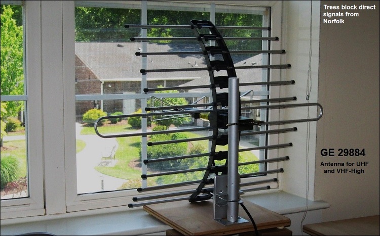

Your signal report looks a lot like my report:
I'm using a GE 29884 antenna indoors
https:www.amazon.com/GE-Outdoor-Supports-Included-Resistant/dp/B01MYMVPVX/ref=asc_df_B01MYMVPVX?th=1
and am able to receive down to RF 7 WTPC TBN:

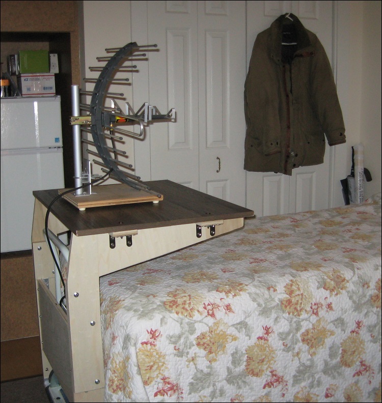

It works a little better over the bed where there is less electrical noise (EMI) on VHF-High channels 7-13:
If it doesn't work for you indoors, add a preamp.
If it still doesn't work for you, the antenna must be mounted outside or in the attic if you don't have an aluminum foil thermal barrier in the roof.
