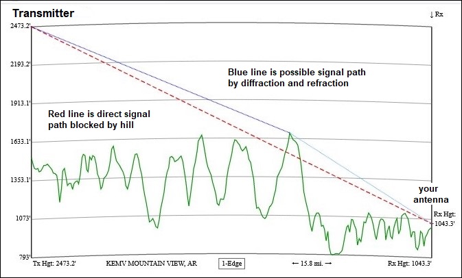

Both reports agree on KEMV. That should be the easiest to receive. It will require a VHF-High antenna like the Stellar Labs 30-2476 and a preamp.
This is the terrain profile for KEMV. VHF signals can make it over rough terrin better than UHF signals.
