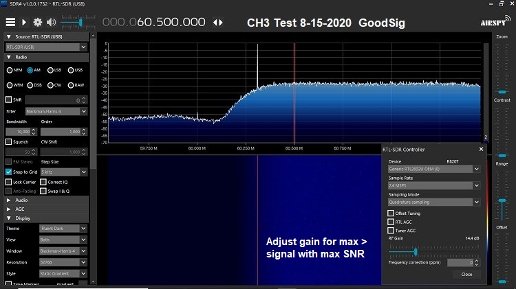

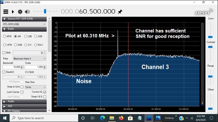

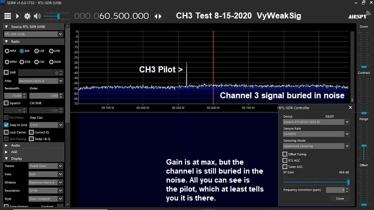

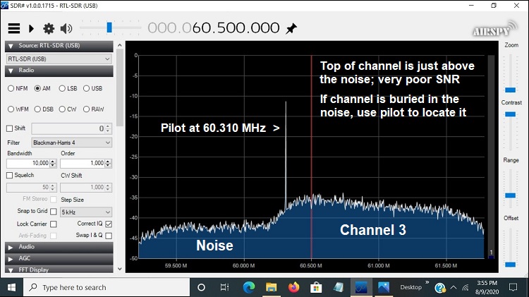

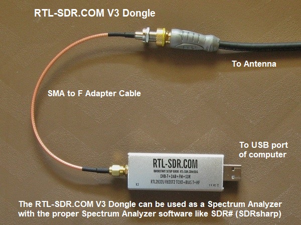

I have been helping a poster in NJ with low VHF on the satelliteguys forum. I taught him how to use a $25 RTL-SDR.com dongle and SDR# (SDRsharp) software to check the SNR of his signals. I suggest you take a look at that thread:
Low VHF interference
https://www.satelliteguys.us/xen/thr...erence.367781/
The 2020 posts start at post #51
Newer version of software. The display doesn't have to be dark, you can set it to a lighter theme, which I actually prefer. I set it dark to match the scans done by freeisforme on the satelliteguys forum:
One of these videos should work:
https://www.dropbox.com/s/w62g62arag...02-32.mp4?dl=0
https://www.dropbox.com/s/w62g62arag...02-32.mp4?dl=1
One nice advantage of having an inexpensive spectrum analyzer is when you are doing a channel scan. If a channel doesn't show up, you don't know if it isn't there or just too weak. The spectrum analyzer will give you the answer.
