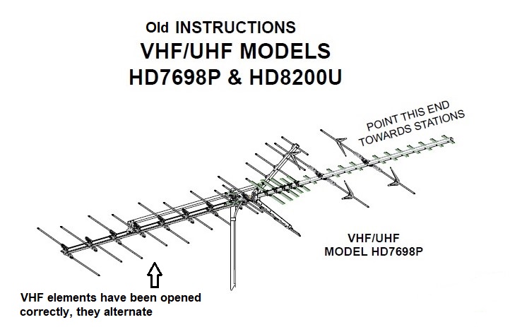

Old instructions with the correct image of the Winegard HD7698P antenna:
https://manuals.solidsignal.com/HD76...structions.pdf
New instructions with the incorrect image of the Winegard HD7698P antenna:
https://d38mfwkkxtsm2m.cloudfront.ne...ts/1450292.pdf

File Type: jpg Winegard HD7698P Old Instructions Image_1.jpg (88.2 KB, 2969 views)
File Type: jpg Winegard HD7698P New Instructions Image_1.jpg (90.5 KB, 2959 views)
