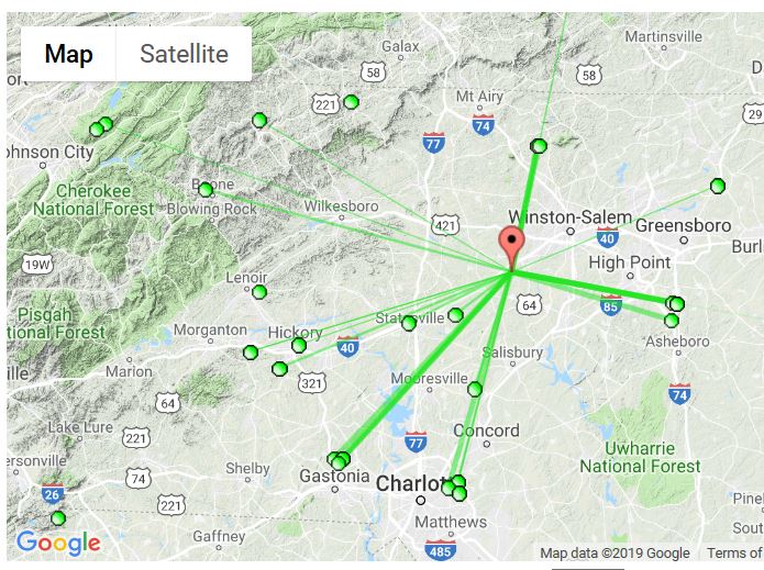

It seems a shame. The TV Fool database has not been updated in a long time.
Hello, Scott
Yes, it is a shame. The TVFool staff is very small, so corrections to the database for the reports is not possible. And, the channel changes from Repack by the FCC make it even worse.
However, I find that a TVFool report is still very useful for a reception analysis, especially when I add a report from rabbitears.info that usually has a more accurate list of channels.
For example:
http://www.tvfool.com/?option=com_wr...9038b79ee8da7a
FM report:
http://www.fmfool.com/modeling/tmp/3...7/Radar-FM.png
