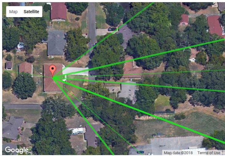

As far as antenna aiming is concerned, it will depend upon which channels he needs. I assume it will be:
KETK NBC, real channel 22, at 151 degrees true, 148 degrees magnetic
KLTV ABC, channel 7, 43 degrees
KFXK Fox, channel 31, 96 degrees
KYTX CBS/CW, channel 18, 140 degrees
He will need a UHF antenna with a wide beamwidth aimed at about 125 degrees for the UHF channels, and a VHF-High antenna aimed at 43 degrees for ABC.

The TVFool Interactive map green signal lines can help with the antenna aim. You can move the marker by drag and drop to the antenna location:
for example:
