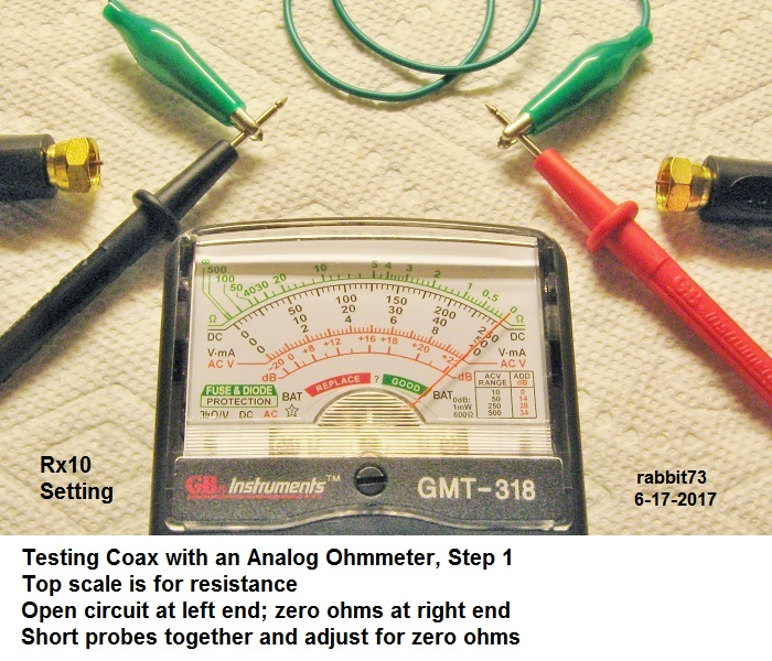

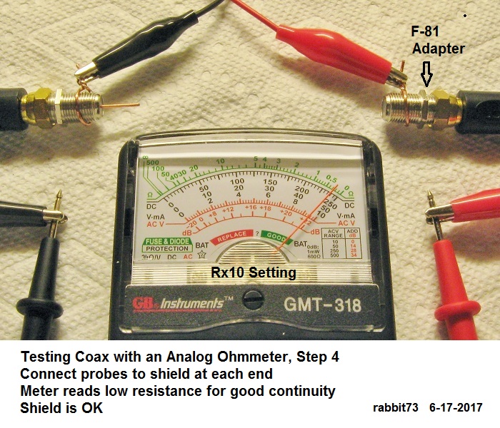

BTW, I think you posted previously about how to test coax cable to see if it was good for reception before you hook it up? Would you mind linking it up here? I haven't been able to find it so far.
OK, here it is:
