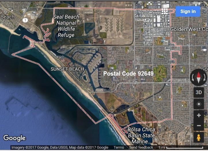

Your tvfool report looks good, but is only based on a zipcode, centered on the intersection of Le Grande Ln and Marea Cir, just south of Seal Beach National Wildlife Refuge, so it might not represent your actual location.
http://www.tvfool.com/?option=com_wr...8e03b2e1cc4490
92649 is a big area:
The green signal lines from the North look like they have a clear path:
Your generic FM signal report shows some strong signals from the North that might interfere with TV reception of VHF-High channels KTTV and KCOP:
http://www.fmfool.com/modeling/tmp/b...e/Radar-FM.png
KTTV and KCOP have directional antennas because they are in the Mexican Border Zone, so you don't get their full power sent in your direction.
http://www.tvfool.com/?option=com_wr...ALLTV%26n%3d17
http://www.tvfool.com/?option=com_wr...ALLTV%26n%3d19
When the signals look promising, but they are weak at the TV, I usually need to ask for more information to figure out what is going on. Maybe some photos of the antenna in its location or a closeup satellite view with the green signal lines. If that doesn't do it, sometimes it is necessary to move the antenna to a different location to find a hot spot.
