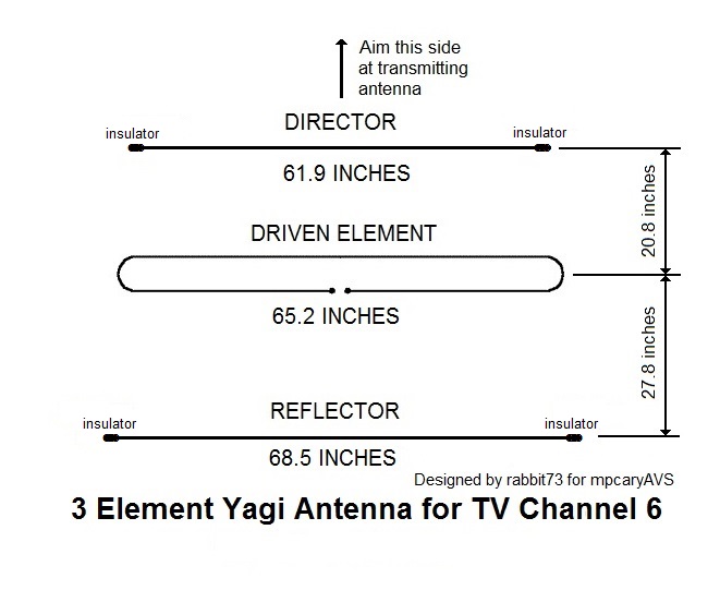

Here is a channel 6 yagi for WPVI:
and the calculations for the channel 6 yagi for WPVI:
Channel 6, 82 to 88 MHz, center frequency 85 MHz.
5540/85 = 65.2 inches length for a folded dipole antenna
To convert the dipole antenna into a 3 element beam for more gain, add a reflector and a director:
Reflector is 105% of Driven Element = 65.2 x 1.05 = 68.5 inches
Director is 95% of DE = 65.2 x 0.95 = 61.9 inches
One wavelength in air is 11810/freq in MHz = 11810/85 = 138.9 inches
DE to Reflector spacing = 0.2 λ = 138.9 x 0.2 = 27.8 inches
DE to Director spacing = 0.15 λ = 138.9 x 0.15 = 20.8 inches
