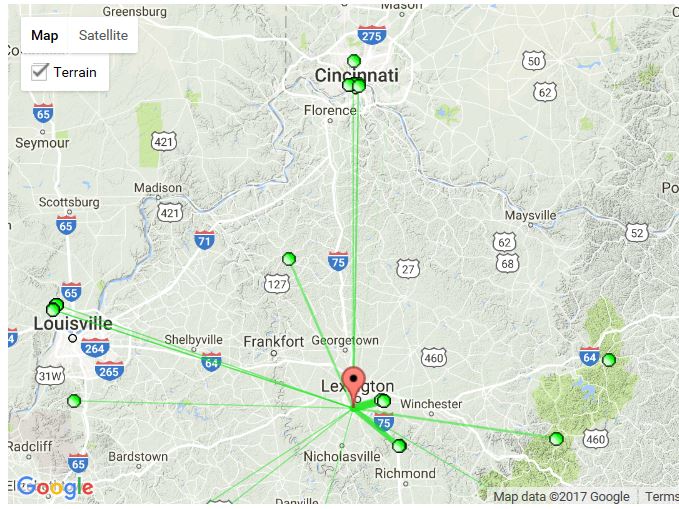

I favor a more simple approach. Mount an Antennas Direct C2 aimed at about 105 to 110 degrees magnetic and be happy with the locals. No rotator needed, because the C2 has a wide beamwidth.
For your distant channels you would need a VHF/UHF combo antenna like the Winegard HD7698P and a rotator which would give you most of the same networks as a simple system. You would probably need a preamp which would be overloaded by your very strong local channels.
