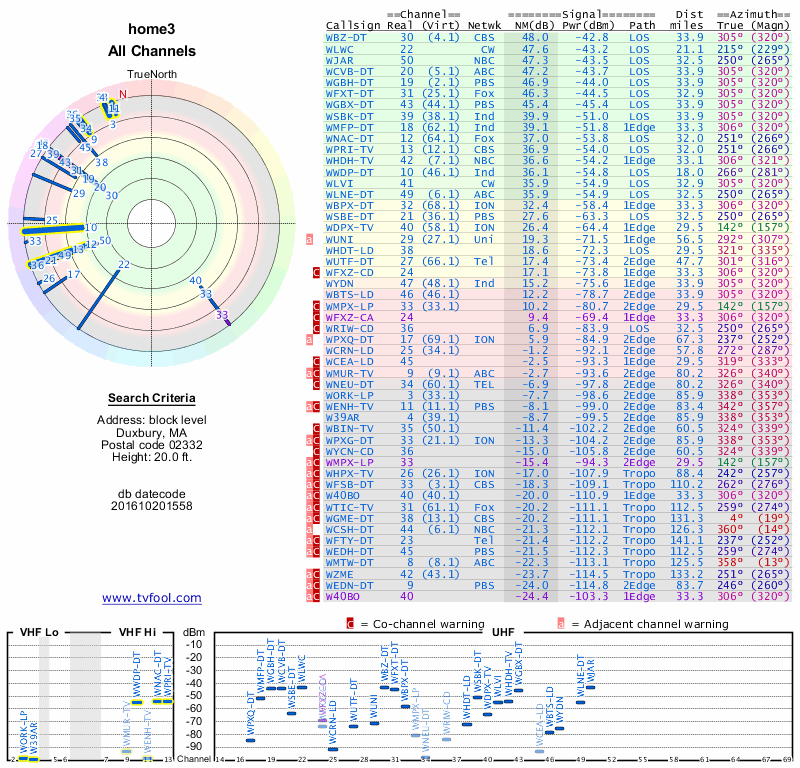

I have three cables coming out of the CM-3414 Ultra Mini 4 amplifier to the individual tv's. Yes there are trees.
From antenna to amp is 50'
tv #1 is 25' from amp
tv #2 is 50' from amp
tv #3 is 90' from amp
See attached radar map
