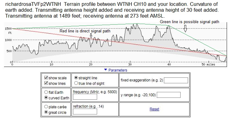

I did a terrain profile for WTNH:
That is a difficult path for the signal. It depends upon atmospheric refraction and diffraction at the mountain peak to get to you.

I think it would be worth the trouble to tilt the front end of the 30-2475 up, or even replace it with the 30-2476. The polarization of the signal is already messed up because of the diffraction at the mountain peak.
