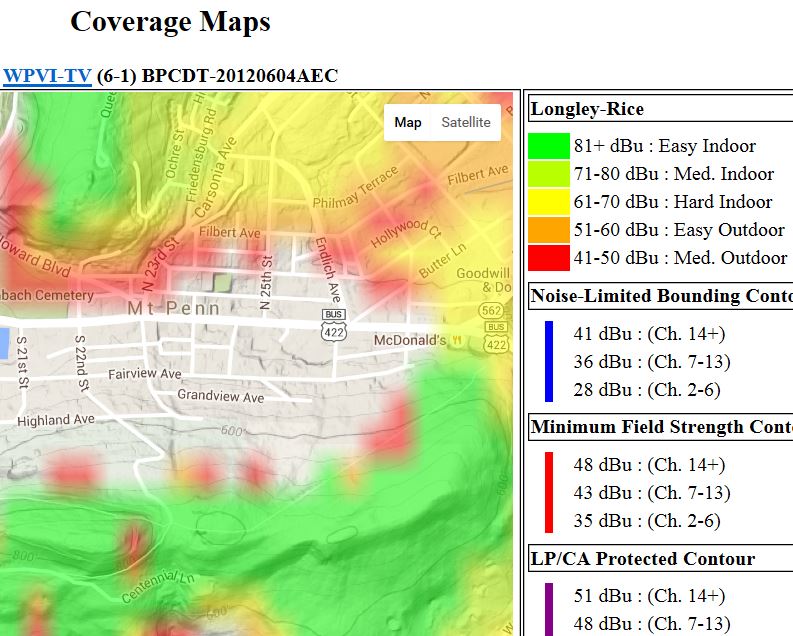

There are three other problems that might affect your reception of WPVI. The terrain profile shows that you are behind a hill for the WPVI signal:
You are in a dead zone for the WPVI signal. Red is a weak signal; no color is even weaker:
