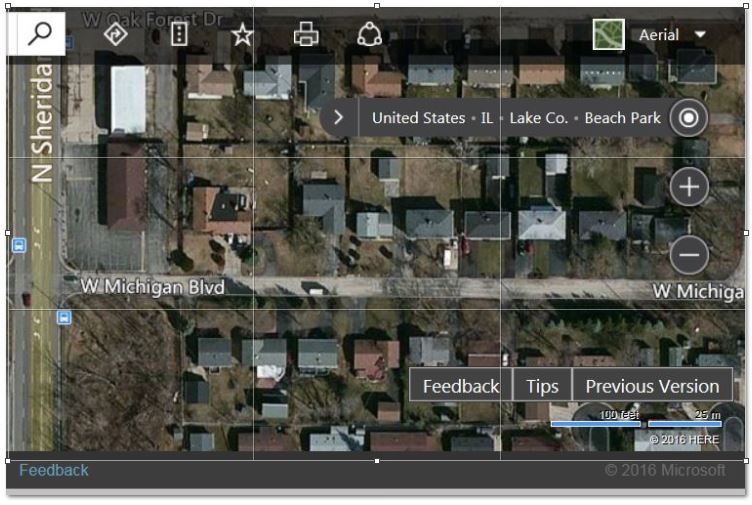

As unimportant as this may seem, My neighbor who claims to know much about OTA TV looked at the aiming of my antennas.
He had his own theories about aiming and provided me with the compass. When I synched my CM9521A north and south, he thought it was off by several degrees. I stated it was square with the road, he said that that was a problem because my road Michigan Blvd is not square with longitude and latitude.
Is there a way to use google earth or other mapping program to show lines of latitude or longitude?
At any rate, it appears my best reception for Chicago is really 166 Degrees and Milwaukee 355, just as TV Fool predicts.

Hi, Bob:
I think your neighbor might be a little jealous of your efforts. I hope he is taking into consideration the magnetic declination of 4 degrees. The Google map is oriented so that the top is True North. I added a grid to the satellite view and it looks square to me. The final authority would be a USGS topographic map of your area that might be at your local library.
I think the argument is unimportant because you are going to aim your antenna for best reception, no matter what azimuth it is. Signals are often skewed and can come in at the "wrong" azimuth.
As long as your rotator can repeat the same direction for you, that's all you need.
