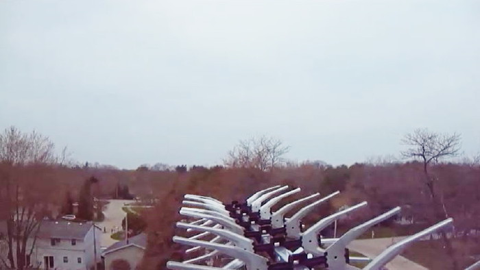

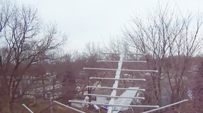

He presently has a HDB91X UHF antenna at the top of the mast aimed at Milwaukee, and a Radio Shack VU-210XR VHF/UHF antenna below it aimed at Chicago, depending on rotator aim.
He is surrounded by tall trees and is trying to raise his antennas high enough to clear them. He made a video with the camera creatively mounted on a 20 ft pole to take photos at antenna height. I made two stills from the video. The first is the UHF antenna aimed at Milwaukee:
the second is the RS antenna aimed at Chicago, which has the stronger signals:
