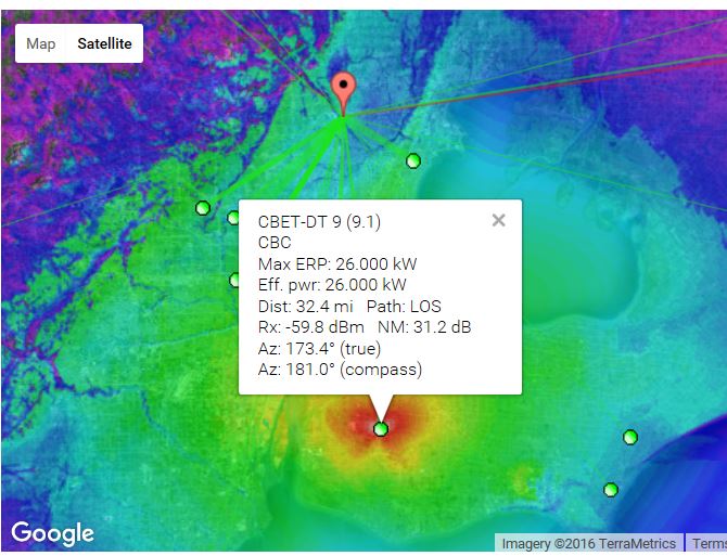

Also, this sounds really dumb, I used my iPhone's compass to set the direction. I set the UHF to about 220 degrees. What do you mean by setting to true north?
That wasn't dumb to try to use the iPhone compass, but the compass in some smart phones isn't very accurate; better to use a regular pocket compass.
If you look at your tvfool report you will see two columns for antenna azimuth, true and magnetic. If you use a compass to aim the antenna, use the magnetic number and that will be the same as the true north reading as shown by the green signal lines on the tvfool interactive map. The difference between the two numbers is called the magnetic declination, and it varies according to location.
I picked a house in your area as an example. If it happens to be your house, it is a coincidence. You can use the green line and a landmark for aim. You can do your own green lines here by moving the cursor to the antenna location:
