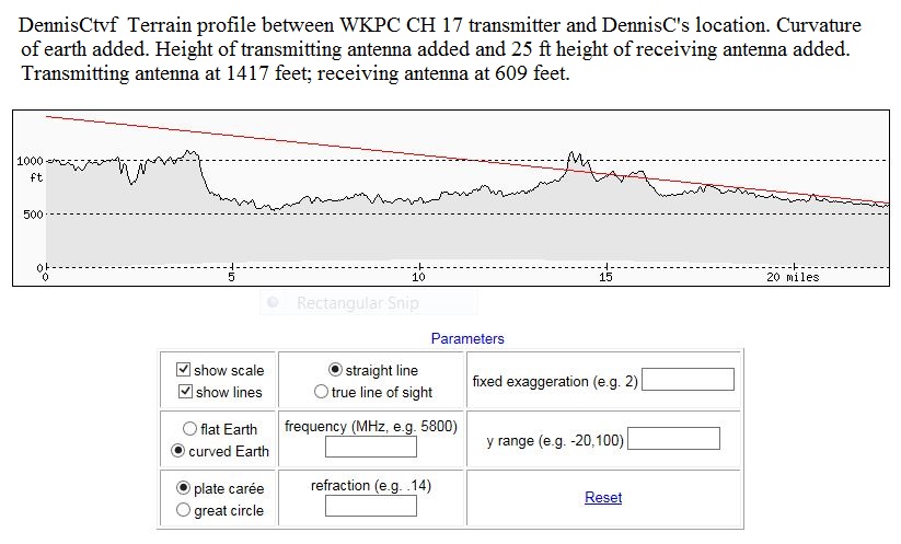

I'm not too sure we can correct your issues. You seem to be doing as well as can be expected considering your tvfool report has many weak signals that have terrain interference and trees probably growing into the signal paths. We just want to make sure that what you are doing is making the best use of the equipment you have. It is possible that if you replaced the U8000 with an Antennas Direct DB8E with both panels aimed in the same direction directly at the transmitter and mounted it a little higher there would be some improvement. Whether it would be worth the trouble and expense, I can't predict.
I think that when WBKI comes in "extremely well" your expectations are raised to unrealistic heights, because it is a Tropo signal that might be terrific at this time of year, but isn't likely to be consistent.
And look at what the WKPC signal has to get above on its way to you:
