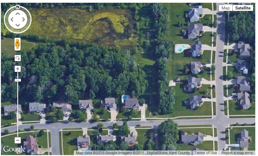

You have some strong FM signals that might interfere with TV reception; add an FM filter in the coax. See attachment 1.

I see a lot of trees in your area; I hope there aren't any in the signal path. See attachment 2.
scroll down to Trees and UHF
