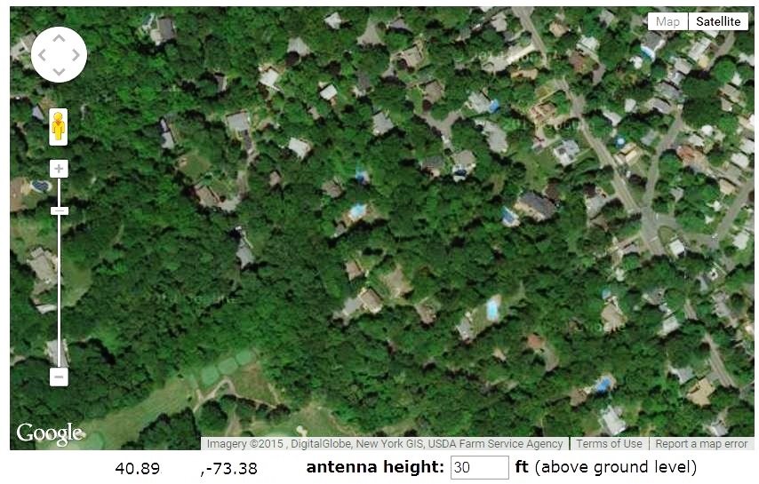

That sounds like the right thing to do. I see a lot of trees in your area; I hope there aren't any in the signal path. See attachment 1.

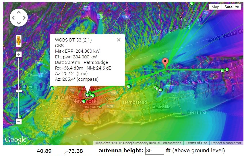

Now that you have tried it without, it's time to try it with a preamp. I don't see any very strong local FM signals to cause interference, but you should try an FM filter. Some preamps have one built in. See attachment 2.

My two main questions are why would I be able to receive other UHF stations from the same broadcast site with similar power, but not NBC and CBS.
My guess would be the difficult terrain between ESB and your location. If you look at the coverage map, you will see you are in a signal dead zone, attachment 3.
