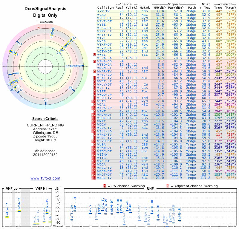

Here is my Channel Analysis Chart:
http://www.tvfool.com/?option=com_wr...40330a07346c5a

but instead of the horizontal reflector elements, I just used a 1/4" screen which I know won't work in snowy weather. It was an experiment and I get 3-1, 6-1 (-2&-3), 10-1(-2,-3). 12-1,-2,-3 and 17-1, and 23-1 are all too weak to lock. I wonder if a pre-amp will help. I'm going get back up there and make a minor adjustment, today. 29-1 (FOX) is also too weak to lock. I do get 57-1 and 61-1 as well as 48-1,-2,-3, and -4.
