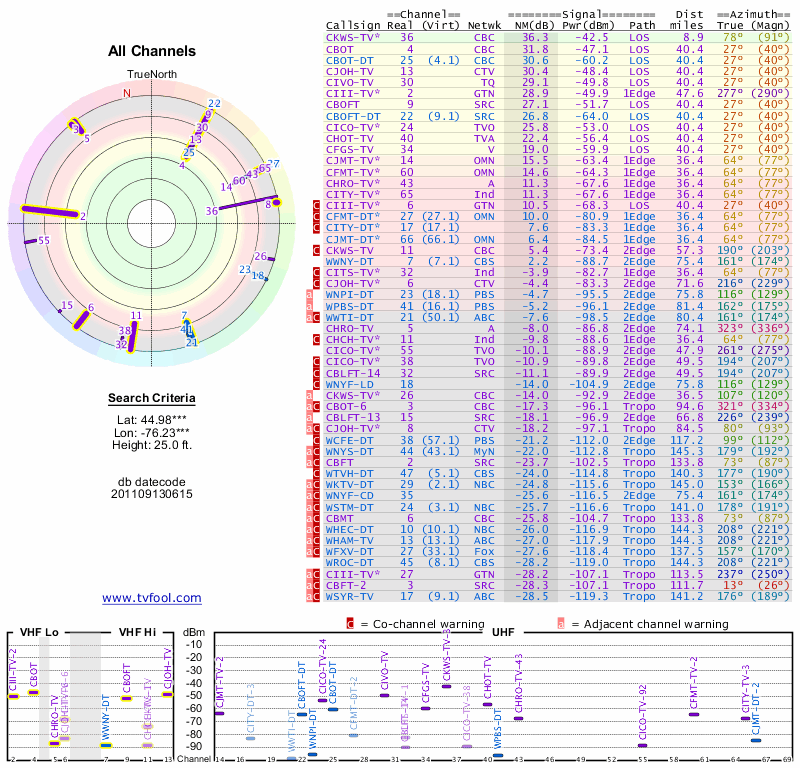

Thank you John...hope this is what was recommended. There will only be the one LG hooked up. I replaced the cable to new RG6 as well. Here is a list of what was sometimes available... 4.1,9.1, 11.1, 13.1, 14.1, 25.1, 42.1, 60.1, 65.1. The most confusing thing was that a channel at one point would come through say at a rotor setting of 117 degrees, go find another station and when you came back to the first channel, 'No Signal' would be on the screen. I would wait plenty of time just in case it was building ? the signal. Thanks again for your thoughts...Richard
