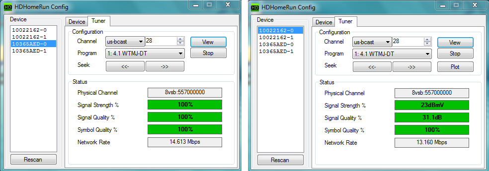

I like the signal quality metering that is provided with the utility software, it reports relative signal strength, signal quality and symbol quality. Not as good as a pro-grade ATSC signal analyzer but a step or two above any other consumer equipment signal indication. The same utility reports the real time data rate of a given channel and some MPEG details. (See the attached screen shots. Notice that signal strength alone does not determine signal quality. Something to think about before you run out and buy an amplifier hoping it will do the antennas job for you.)
http://forum.tvfool.com/attachment.p...1&d=1299721662
HDHRHomeRun Config (GUI) - Antenna A
http://forum.tvfool.com/attachment.p...2&d=1299721670
HDHRHomeRun Config (GUI) - Antenna B

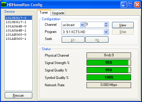

My 2 problem channels
Channel 15 shows
Signal strength shows %50
Signal Quality shows %0
Channel 51 shows
Signal strength shows %30
Signal quality shows %0
I guess this was the question I was refering to on your post about the amplifier. Will it help? Can you explain the difference between strength and quality?
GroundUrMast 2-May-2011 5:45 AM
@ sdubb
My experience with the HDHR has been that any signal strength or quality below 50% is an indication of imminent errors which will be visible as pixelation or signal loss.
Signal strength is an issue for you in the case of both channels. An amplifier might help... if the signal at the input of the amplifier is not already 'buried' in noise, distorted by multipath or other impairments which amplifiers are incapable of fixing. In other words, the antenna must be receiving a usable signal with enough quality to tolerate the damage that the amplifier will cause. http://forum.tvfool.com/showthread.php?t=1514
